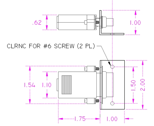

considered offering a relay something like this
[img]cid:.0[/img]
http://www.digikey.com/product-detail/en/TQ2SL-12V/255-2853-ND/649407
mounted within one of our stock d-sub housings sorta
like this . . .
[img]cid:.1[/img]
This is one way to incorporate such relays in
a manner that looks more business-like for airplanes.
Also much less prone to failure by reason
of installation shortfall . . .

Good for you . . .
The legacy DSub shells have internal dimensions
that closely mimic connectors themselves. The D15
backshells I use have internal 'thickness' heights
on the order of 0.45"
The relay you choose must have at least one dimension
equal to or less than the internal height of the shell.
If you like, I can mail you a shell and bracket. The
connectors and hardware are prolific.
Relays too. . . there's probalby 100 parts
in the Digikey catalog suited you task. First
crack at a search
[img]cid:.0[/img]
http://tinyurl.com/p3f3cbh
A surface mount version is good . . . you might
have to cut pins off anyhow. Neat doesn't count
Use solder cup connector and 24 or 26 awg wire.
Solid wire is okay . . . after you've check it
for functionality, you'll pot it with hot-glue.
Let me know if you want the parts.
