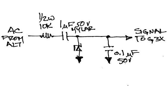

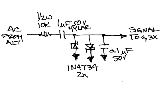

the fluctuating of the tach is something like this. When I take off the tach is around 2650 rpm and fairly steady. After starting to climb out, the tach shows anywhere from 330 rpm to 3300 rpm, or the display will "red flag" the instrument. The rpm will vary in those ranges. Yesterday, it happened on the ground.
The wiring for the tach hookup is a single shielded wire from the alternator output to the Garmin GEA-24 box. In the setup for the system, you select "jabiru alternator" as the choice for input. I thought it seemed pretty simple, but has proven to be elusive.
I have no idea why this is occurring. So far, we can't recreate the issue consistently to pin point a common cause. My limited experience and knowledge has me looking on these sites for assistance. My "avionics" guy that did almost all of the wiring is at a loss.
It's a fairly common practice to deduce engine RPMs
by sampling the frequency of the AC voltage produced
by the permanent magnet alternator. If there were
nothing else attached to the alternator's stator winding,
the output would be a clean sine wave signal. Pretty
easy to 'decode' for its information about frequency.
As soon as you hook a rectifier/regulator to the alternator,
there's a host of noises that get impressed on these
wires that make the voltage anything BUT a clean
sine wave. There's a certain amount of signal conditioning
needed to reject the trash leaving the tachometer
circuits with clean data.
I'm betting that your particular configuration
presents a noise signature at the ragged edge of
Garmin's design considerations. At the higher
RPMs there are artifacts of rectifier/regulator
switching noises that are confusing the tachometer.
According to my copy of a g3x installation manual,
the Jabiru signal is known to be 6 pulses per rev
off the alternator winding. So 2400 RPM x 6 is
14,400 pulses per minute or 240Hz. A relatively
easy experiment to conduct is to fabricate a
filter like this . . .
[img]cid:.0[/img]
This filter has a frequency roll-off in the neighborhood
of 240Hz and would be a strong attenuator of
artifacts of higher frequency.
You can solder all the parts together and
cover with a piece of heat-shrink. You would
have three leads coming out, AC Input, Signal
Output and Ground. This network would go a long
way toward limiting the high frequency noises
that I think are confusing the G3x.
Bob Nuckolls

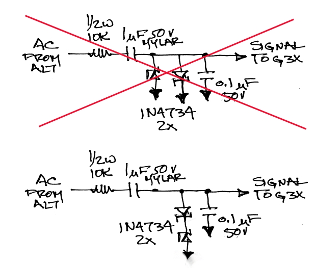

nuckollsr
Joined: 24 Mar 2009
Posts: 95
Location: Medicine Lodge, KS
PostPosted: Mon Mar 09, 2015 9:23 am    Post subject: alternator voltage output Reply with quote
OOPS!!!! Got my tongue wrapped around my eyeteeth and
couldn't see what I was drawing . . . There was an
error in the first drawing that would have resulted in
a really poor performing filter. Drawing corrected
below . . .
[img]cid:7.1.0.9.0.20150309122111.01c08da8(at)aeroelectric.com.1[/img]
Bob Nuckolls
AeroElectric Connection
P.O. Box 130
Medicine Lodge, KS 67104-0130

At 13:04 2015-03-09, you wrote:
The Jabiru alternator coil floats with respect to the electric
ground. The signal relies on parasitic capacitance and whatever
leaks inside the regulator. You'll get a much steadier signal if you
also tie a 10K 1/2W resistor between ground and the alternator wire
that you didn't use for the G3x input.
I had poor indication on a UMA tach, solved it using the resistor
above but found it interfered with the 'low charge' output from the
regulator. The final fix for me was to use an audio transformer as a balun.
Rob
That's another good approach. Yes, the AC power
coil is 'floating' but when connected to the
rectifier/regulator, either side of the ac winding
is either a volt or so above ground (- half cycle)
to many volts above ground (+ half cycle) . . . and
the wave form is really ratty . . .
Going across the AC winding with the isolation
transformer gets around the wave form distortion
generated by the R/R.

curts63
Joined: 04 Dec 2013
Posts: 30
Location: New Ringgold, PA
PostPosted: Mon Mar 09, 2015 11:17 am    Post subject: Re: alternator voltage output Reply with quote
Bob,
Thank you for the information and sketch. I'll give this to my avionics guy tonight and see if we can get the parts. I'll let you know if this works.
Thanks again,
Curt

First, thank you for the input and problem solving. I wanted to let you know that the "filter" that you suggested did a rock solid job from 0-3000 rpm. When I'm at full throttle, I still get a fluctuating tach, but at least now it doesn't flag.
Curt

Oh man . . . I think I was supposed to send
you some parts for that . . . I think I dropped
the ball.
Okay, my next best guess is that the signal is
still too big. Try removing one of the series
zeners . . . trimming it down to this:
[img]cid:7.1.0.9.0.20150329133937.010c0048(at)aeroelectric.com.0[/img]
If that's still short of rock solid stable, try
adding more 0.1 uF caps in parallel across the
signal line.
Sorry 'bout that kit.
