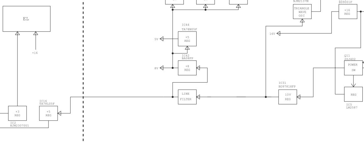

Less than 30 hours on unit, but out of warranty. Radio works well for a while, then without warning display will dim then disappear. Dial lights are still on and can transmit and receive but nothing showing on display. Have already replaced the ribbon cable.. No problem for 10 hours of flying, then problem started again. Power off and on works sometimes, but most times display does not light up. Even tried turning dimmer function off.

The A210 has an EL display and I would start by looking at the voltages supplied
to it. The service manual shows IC75, a BD9001F IC supplying 16V and IC2, an
NJM2307001 IC supplying 3V.
Email me if you'd like me to email you the service manual (a 10MB file).
