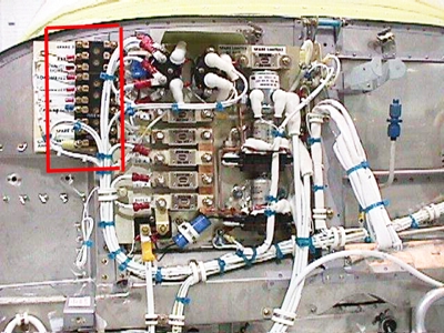

I think we also dabbled with the use of fusible links
on the meter-leads to a shunt. As a general rule, the
fusible link is attractive only when a fuse holder
is a little 'messy' . . . The TC fleet has used two
fuses in clips to protect ammeter wires for decades.
[img]cid:.0[/img]
The last time I was able to walk down the A36
production line (about 10 years ago) the clipped-in
fuses for various 'minor' tasks were quite visible.
The need to extend the bus to accommodate the only
circuit breaker in the airplane was a special case.

PostPosted: Thu Dec 04, 2014 9:15 pm    Post subject: Fusible links Reply with quote
Bob ,
Was that photo of the fuses/wiring in the engine compartment?
Bevan

[img]cid:307341305(at)05122014-0D5B[/img]
Like Figure Z-13/20, and to some extend Z-19, I've
regretted having published the ideas. While useful
and appropriate to the special cases, they've
morphed into other forms that may or may not
have been through PCQDR (preliminary, critical
and qualification design review).
