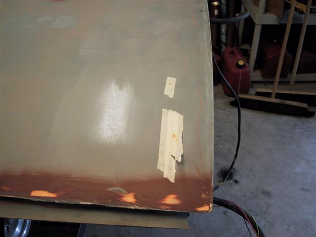

I have one tank that is weeping through the glass. I see Skystar had this problem and offered replacement at one time. Is there any way to repair this? from the outside? Inside? Sloshing seems to be out, I had as good a look inside the tank as possible with a small webcam on a dowel and they seem in good shape other than the small spots shown as dark on the masking tape.

It looks like these tanks are new and never been installed. What year were they manufactured? What type fuel did you use that showed the weeps? With the rapid use of Ethanol, it makes the tank questions much harder. I for one do not think an outside patch is the way to go. I also don't feel comfortable with sloshes (Just my opinion). However, short of cutting the tanks open I might consider a large outside patch of glass and epoxy resin. I would always be suspicious of the rest of the tank area and future leaks.

Very small pinholes which is why Skystar used the internal sloshing
stuff. Clean it and and epoxy on the outside? The pinholes are very common.
Paul
dosmythe(at)cox.net
PostPosted: Tue Sep 12, 2006 7:12 am    Post subject: Leaky fuel tanks. Reply with quote
I might add one more suggestion if those are new/never installed tanks.
Clean the outsides very good. Mix up some good epoxy resin and coat the
entire outside of the tanks. Use a plastic scraper and put the epoxy on as
thin as you can. Epoxy (especially when lightly warmed with a hairdryer)
will wick into the smallest of pin holes. This might just add a little
extra assurance.
Don Smythe

Hi Don, these tanks have been used for ~500 flying hours. with avgas and CDN auto gas, so likely no ethanol. The show the laks I just tossed a gallon of gas into them and let them sit for a few days. I knew where it was leaking and wanted to see how bad it was. Is regular epoxy resin gasproof, I have some really nice tight weave fiberglass cloth.

How about one more suggestion, Don....apply a SLIGHT vacuum to the
filler cap area via the vent tube and maybe it will help draw the epoxy
into those small pin holes...just a thought. A vacuum cleaner might do
the trick, or running your car's engine might do it...NOT AT FULL
vacuum, though...don't want anybody sucking those expensive tanks into
junk!
Personally, I did the slosh method, and have over 150 hrs on the plane
without (knock on wood) a problem yet. My tanks were 12 yrs old with no
fuel ever in them when Frank Miller suggested that I clean and slosh
them. I use only avgas...when you burn only 3.3 gals/hour, it's
affordable, I feel.
Lynn

Sloshing the tanks works ok so long as theey are flushed out well to get rid
of the waxy coat left from the mold. Detergent is no good, MEK or the likes
is needed.

I've decided to go with epoxy on the outside and possibly a sloshing
compound as well. Do you have to coat the whole tank inside or can you
simply roll the compound around the area of concern? My tank has two
internal baffles that will complicate things a little.
Fot the outside epoxy, I've decided to go with the Hysol that I already
have. The website lists it as being impervious to almost everything this
side of Kryptonite, so it should perform this small task well.

I think it is better to slosh the whole thing and not
allow an edge for the fuel to get under. The slosh is
fluid enough to slowly go around the baffels. Then
you can rotate it every few minutes and get a good
layer built up. Then pour out the excess, no problem.
Of course, apply the epoxy on the outside first,
especially if you put "a little" vacuum on the tank.
Kurt S.

And the fact that you're sloshing it BEFORE you put it in the wing
makes it a whole lot easier. Unlucky me learned about the need to clean
and slosh only after installing the tanks into the wings. Not fun
sloshing a 12-foot wing inside an 11-foot 10-inch building.
Lynn
