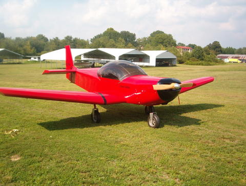

>>> Listers-- I hope this won't be too boring to you veteran Zenith
>>> pilots out there but I got a chance to fly a friend's brand new
>>> 601HDS registered as N201MS. It's powered by a Continental A 75-8
>>> (75 hp) motor and is a tri gear model. I thought it might be
>>> interesting to those who have flown one, but not both wheel
>>> configurations of Zenith 601s if I shared my reactions. I wrote
>>> this review after flying N201MS for two hours. I think my hours
>>> were number 10 and 11, so it's a brand new bird! Mike Stewart was
>>> kind enough to ask me to help fly off the Phase One hours since he
>>> has watched me tweak my HDS/Jab 3300 taildragger for over 150
>>> hours. He has also owned or built over 60 airplanes and did the
>>> first flight on my 601HDS so he knows his stuff! The original
>>> post was to our Yahoo group called: 601_HD-HDS. There are more
>>> pictures and information posted there. The group was set up for
>>> Georgia area Zenith drivers to communicate but it is open to
>>> everyone. I am sure my experience will not be the same as everybody
>>> else's but I just call them the way I see them-- One additional
>>> note-- the aileron stiffness I noticed is now completely gone.
>>> Mike found a binding bearing and fixed it so it's effortless to use
>>> ailerons now. He says that when I get out of his plane next time I
>>> will head for mine and pick up the shears to put hinges on my
>>> ailerons. We will see-

>>>> To recap Mike's configuration it's a VERY light 601HDS (speed wing)
>>>> that actually came out lighter than Chris Heintz' prototype at 569
>>>> pounds. It's powered by a Continental A 75-8 non- electric motor
>>>> swinging a 60X58 pitch Tennessee prop. That's 8 inches more pitch
>>>> than my Jabiru 3300 120 hp motor is pulling! Mike and Tennessee
>>>> Propellers came up with that configuration after looking at
>>>> performance charts and projected cruse speeds for the A 65(at)2300 rpm.
>>>> Tennessee actually sent a 58 inch pitch rather than the 57 that was
>>>> agreed upon. In spite of this optomistic task for the little A75, A
>>>> digital tachometer confirmed 2260 static rpm with the prop. It easily
>>>> cruses at 2300 at altitude and gives a bit more, but not much at full
>>>> throttle.

>>>> rest of us it's a refreshing little plane with nice manners and
>>>> surprising performance for it's power.
>>>> What will Mike's Aircraft Factory come up with next?
>>>> Ron DeWees
>>>> N601TD

PostPosted: Mon Sep 11, 2006 8:25 pm    Post subject: Tri gear vs tailwheel test flight Reply with quote
Hi Ron,
Thanks for the great flight report. It sounds like a really nice plane.
I do wonder, however, about your comment regarding stall speed and
being qualified as LSA. The 51 mph sounds OK, but I would have
thought the performance should be tested at full gross weight. I
gathered from your report that you were probably flying solo and a
couple hundred pounds under gross.

PostPosted: Tue Sep 12, 2006 3:25 am    Post subject: Tri gear vs tailwheel test flight Reply with quote
Hi Paul,
Yes, It's solo-- (has to be for the first 40 hours) and WELL under
gross. Turns out that the plane's gross weight is more than twice it's
empty weight . 569 empty and 1200 at gross. That's pretty amazing for
a 75 hp plane!
Ron
