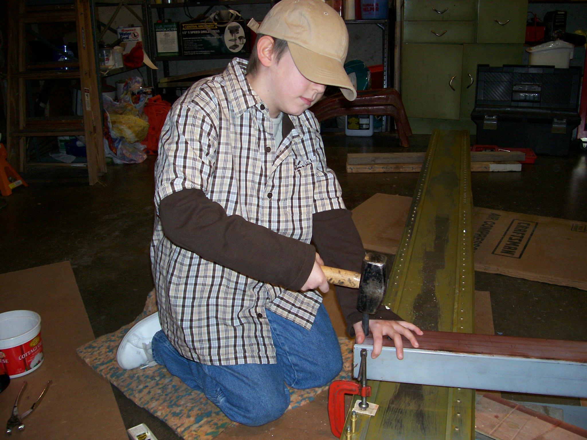

A while back someone asked for a picture of a Spar being scratch built. Here's on my Grandson is working on:)

I was the guy making the inquiry about scratch building spars. Thanks for sharing the photo. I'm to the point of deburring all those many, many holes. Any advice you have to offer would be appreciated.
Start deburring!

Check the archives regarding a special type of file - the name might be
a Vixen (somebody have the exact name?). It has curved ridges and
lightly rubbed against the line of rivet holes, takes a lot of the rough
stuff off. Then deburr in the normal manner with a drill point, etc.

Yes, it's a vixen. (This is a reference to a type of file, not to a foxy
stripper from NAPA.) If you can't find a vixen file, try a laminate file.
They are made for use on Formica-type laminates, but they do a good job on
aluminum.

use a short vixen file or a dog leg de burr tool.. I prefer the
latter, to each his own.
