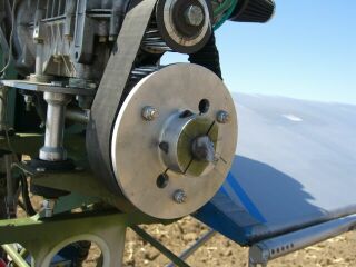

Two blade... And remember this is a belt drive, not a gearbox...

Which belt redrive was it? I'd suspect the redrive, and switch to the proper gearbox. Haven't heard of any GB's letting the prop depart the aircraft.

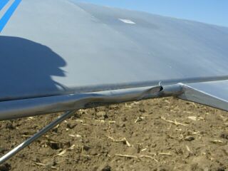

At 12:01 AM 9/3/2006, you wrote:
>Well, there's a Warp Drive prop somewhere West of Chowchilla,
>CA... I think it ended up in a corn field... Prop shaft (belt
>drive) broke forward of the hub and the hub and prop departed my 503
>Firestar at about 1000' taking the right aileron spar/torque tube with it...
Never seen a 503 Firestar with a "belt drive" - what's it look like?
Who's idea was that?
But, then again, I don't get out much.

David.Lehman
Posts: 265
Location: "Lovely" Fresno CA
PostPosted: Mon Sep 04, 2006 5:17 am    Post subject: Re: Need new Prop Reply with quote
[quote="Ed in JXN"]Hi David,
Ed in JXN
MkII/503
Hi Ed...
I don't know the manufacturer of the belt drive...
I think this Kolb is/was an excellent example of "you get what you pay for"...
If it ever flies again, it will be with a gearbox, or direct drive, no more belt drives for me...
DVD
