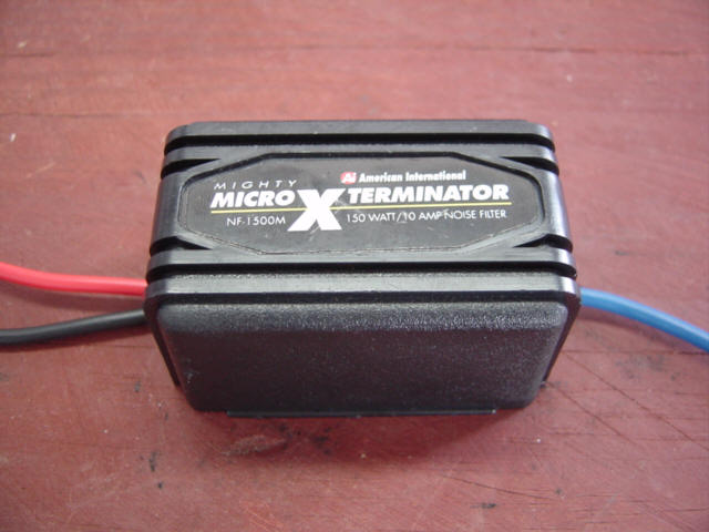

Hi all,
I'm wondering if someone could educate me a little on something I
encountered while trying to eliminate electrical noise coming from an
autopilot servo. The story goes like this:
I recently installed a new autopilot servo in my Berkut (all composite). It
worked perfectly, but for some reason, the servo makes a loud squealing
noise in the intercom audio when it's activated. I did all the usual
things - changed ground points, increased grounding, double checked
shielding on cables, un-bundled wires, ferrite beads on the cables, etc.
The only thing that really worked was to power the servo from a separate
battery - indicating electrical propagation, not RF. I spoke with the
manufacturer, and they did mention that there was a 2.5KHz PWM signal that
is used to control the servo, and that the "noise" I hear is likely that.
So, on to trying to isolate the servo from everything else...right.
I first tried (at the manufacturer's request) a pair of capacitors (.1uf and
4700uf) in parallel, grounded off the servo power lead itself. This did
slightly dampen the noise, but certainly not enough. So, I also went out
and purchased a common 10-amp car audio power filter - just like those sold
by Radio Shack and documented by Bob on his site - 2 caps with a choke coil
potted in a case although I can not see the ratings on the caps. I placed
the filter in an orientation that isolated the power source from the servo,
instead of servo from power source as IT was the verified source of the
noise.
The good news is, that filter eliminated about 99% of the noise - and that's
good to go. I have not yet done extensive tests to see if the AP now
operates properly in flight with the filter in-line (possible I/O errors,
proper servo feedback, etc)...that's coming soon. But, I want to explore
the "weirdness" first.
Now, the weird (to me anyway) part is that the filter itself now audibly
"sings" with the same frequency that I had heard before on the intercom. I
mean, it literally makes the noise like a speaker would. Is this normal?
What would be causing that? Is this symptomatic of some additional problem
that might effect servo operation? Something else I should do or try?
All information and education is welcome...but remember, I'm not an EE. Wink
Eager to learn,
James Redmon

[Barry] Weird to me too? Are you saying that the filter has a noise coming
from it? If so then your GROUND is poor and maybe your leads too long. This
of course is assuming that the filter is made well and the coils of the filter
are mounted / potted securely. But, the first thing I would check is the
GROUND.
Other thing to check would be your crimps. I would rather have you tell me
that you soldered these connection.
Barry

You are putting current pulses through an inductor so it has a
magnetic field that is varying with the current pulses. Any steel
object nearby is going to be alternately pulled and released by the
varying magnetic field. It is probably the case of the inductor or
the inductor's core that is making the noise.
OTOH, there shouldn't be that much current change. Put the capacitor
combo back at the input to the servo.

Well, 2.5 KHz is within the audible frequency range. The A above
Middle C is 440 Hz. So you're only talking about less than 6 octaves
above it. All it would take is having the coil inside the filter
that has this frequency applied to it being physically in contact
with the case or other structure. I can envision that real
easily. We usually call that "headphones" or "loud speaker". So,
you might have to take it apart and make sure the filter is
physically isolated from the box around it using RTV or rubber
gaskets or something.
Be careful about filtering the PWM signal, though. The whole purpose
is to feed that signal to the servo, and if you are applying a filter
that changes the shape, the servo might start functioning incorrectly.

james(at)berkut13.com
PostPosted: Sat Aug 26, 2006 6:45 am    Post subject: Noise filter noise Reply with quote
Humm...given the potting inside the filter, I think I'd end up destroying it in the process of dis-assembly. I might try replacing the whole filter.
Attached is a picture of the unit - I have not been able to track down any electrical specifics.
Curious, if one of the two capacitors went bad, wouldn't it fail (at least partially) to squelch the noise and no longer "filter" as well? Or is there a partial failure mode of a capacitor that I'm not aware of?
Thank you all for the help and ideas - it's very educational.
I'll fly it today, and see if the servo is operating properly with and without the filter attached. (it's rigged as a small jumper cable so I can easily plug and un-plug it)
I think if the AP servo works properly, I'll just let the filter audibly "sing". At least there's no appreciable noise in the headsets.
