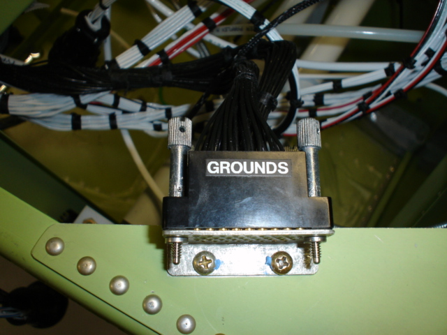

One thing to consider here is that there are now two extra holes in a
structural piece that were not envisioned by the aircraft designers. I
usually try to avoid putting any additional holes in pieces that hold the
engine or gear or flight surfaces securely

Where did you find those connectors?

Here is one option. There are two similar ground connectors mounted above
and below the triangular reinforcement where the firewall and top longeron
meet. There are at least thirty ground pins available in each connector.
The paint was removed under the mounting. I am planning to also terminate
the large ground lead from the engine on the same triangular reinforcement.

B&C has several different configurations of 'forest of tabs' grounding plates:
http://www.bandcspecialty.com/cgi-bin/ez-catalog/cat_display.cgi?26X358218
-Dan Masys
