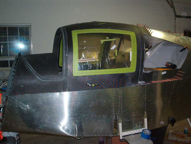

Here is a photo of the CH2000,CH640 cabin structure.

PostPosted: Tue Feb 13, 2007 5:33 am    Post subject: Re: Gull-wing Doors Reply with quote
I see no reason why that can't be easily adaptable to the CH601XL. If you ask me the CH2000 looks just like a CH601XL except with a hardtop canopy.
[img]http--www.airbum.com-pireps-CH20001.jpg[/img]
Doesn't even look all that difficult to make, unless I'm missing something.

The 640 may be similar to the 601XL, but look at the proximity of the spar insertion hole to the main landing gear attach bracket. It's MUCH different from the 601XL. I see quite a few, less obvious, differences in the fuselage structure. It's nopt just a 601XL with a different canopy.

I'm sure a 640 or a ch2000 aren't just a scaled up version of a 601xl, but they are very similar looking from photos, especially before the canopy is installed. I don't see any obvious reason that a canopy from one model couldn't be adapted to another model. I guess what I'm getting at is that in either case, the canopy doesn't appear to add to the structural intengrity of the fuselage, certainly not in the XL and I would venture to guess that it doesn't add anything structurally from a design stand-point (that's needed anyway) to the CH2000 or the 640 and any additional strength it does add is just a bonus, kind of like a hardtop versus convertible car. You can put the top down or cut the hardtop off a Chrysler Seibring and it wouldn't effect the strength of the chasis because they're built on the same chasis and the structural integrity is not compromised sans a roof.

I am sure that you could adapt a similar designed canopy to the 601, however it would have to be built from scratch, not a modification of the 640 canopy because the dimensions are all different. In the 640 it is a structural component of the fuselage, tying the upper 1/2 of the firewall into the fuselage. It is also quite complex, made completely of carbon fiber, with many areas a sandwiched structure with an inner and outer layup. Since it wouldn't be primarily structural in a 601, you could probably make a much simpler design and use fiberglass rather than carbon fiber however it would have to be pretty sturdy to give adequate support to the doors and the roll over protection you are looking for. Also, being a very well made $4000 piece of the 640, it is definitely not cheap.
Good info. I was wondering it was structural or not in the 640. Obviously it wouldn't be in the 601XL so the contruction woould be easier. I'm going to have to look into this.
