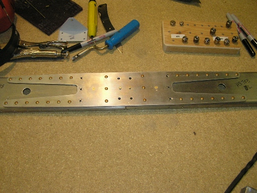

Darwin . . . or anyone else. Exactly what is the size of the
hole under discussion?

PostPosted: Mon Aug 14, 2006 6:16 pm    Post subject: Electric Elevator Trim connector Reply with quote
Bob, here is a pic of the hole in the rear horizontal stabilizer spar
(RV-9). I have mine stored but you can see the hole is approx. 5/8 to 3/4".
