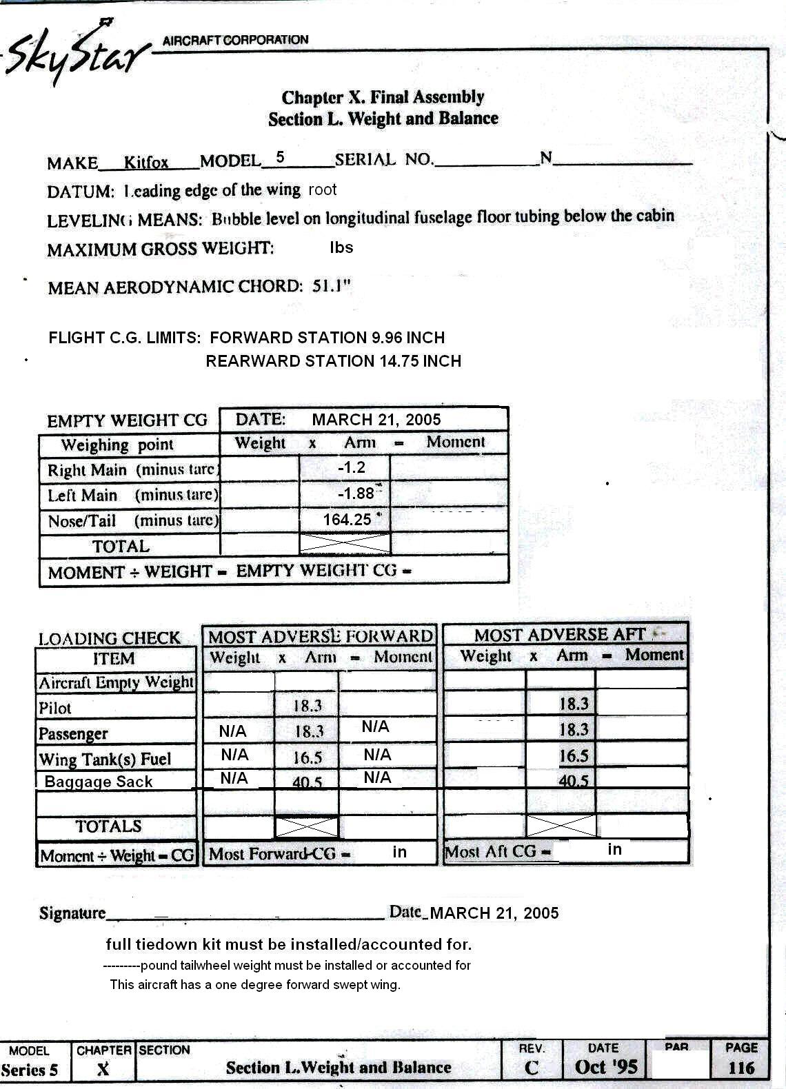

I will try to attach a much smaller jpeg file that I found. Hope it comes0 thru ok. I don't know much about changing formats. I edited the numbers off0 of this one so you would have a blank one. I will also try the recommended way0 to reduce files. thanks and Good Luck. An associated note said
" NOTE: it is recommended that flap deflection be limited to (unspecified)0 notch on Series V tail draggers when operating at CG stations forward of 11.700 inch. The aircraft may not be able to achieve a three point attitude upon0 landing at extreme forward CG stations with full flaps.
FLIGHT LOAD FACTOR FLAPS UP + 3.8g - 1.52g"
since our series 5 with 2.2 Eggenfellner subaru has electric trim0I0 cannot associate with notches of flaps.

the source of this note is page 2-4 "OWNERS MANUAL AND PILOTS OPERATING0 HANDBOOK SERIES V" dated July 2004
AMuller589(at)aol.com
PostPosted: Tue Aug 08, 2006 2:53 am    Post subject: small file Blank series V weight and balance Reply with quote
Attached is subject page from SERIES V POH page 2-4. I found a way to0 reduce it from 2.4mb to 266.4KB. Hope I can figure a way to repeat it for future0 X-MSN.

PostPosted: Tue Aug 08, 2006 5:18 pm    Post subject: small file Blank series V weight and balance Reply with quote
I can confirm it is true on my S-5 for over 50% flaps
and FWD CG. I run out of trim at around 60 knots and
no flaps. Still can get enough elevator until 1/2
flaps. After that it is difficult to get the tail
down with FWD CG. Just never saw it in a note before.
Kurt S.

Hummm. Didn't have it in my older copy I guess or I
think I would have remembered it. Mine is at the
hangar. I'll have to check it later to be sure.

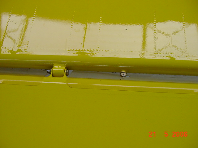

I closed the gap from the stabilizer to the verticle
stab hatches with foam as much as I could when I built
mine just to increase the elevator authority. It has
no gap now when at full nose up stab. (stab front
down to the widest part of the verticle stab)
Later I plan to put in gap seals too. If that isn't
enough, I can add VG's under the stab or move that
little battery I have just aft of the firewall to
adjust the CG a little.
But for elevator authority you need to close the gaps,
make sure you have full elevator deflection, but no
more, and then stay within CG limits. That should do
it. Move some weight aft if you need to.

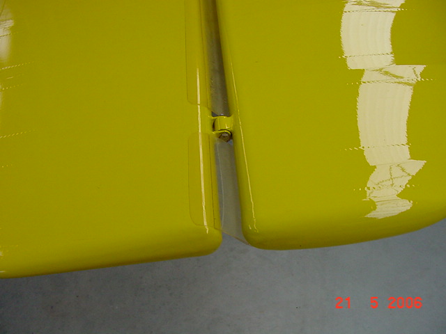

PostPosted: Sat Aug 12, 2006 4:23 am    Post subject: small file Blank series V weight and balance Reply with quote
I think we had a similar discussion a while back. Try closing the gaps on
the elevator with clear tape, as seen on the Sportflight pics. While I can't
confirm a huge change on mine, others swear by it for getting elevator
effectiveness. I noticed an improvement, but nothing radical.
Also, a forward CG is a classic scenario of running out of elevator at low
speeds (in the flare). As the CG moves aft, the elevator gets move
authority, but it also gets more sensitive to small inputs at higher speeds.
Eventually it will get uncontrollable. Forward is better than aft, but you'd
be relegated to wheel landings.

My CoG position sounds identical to yours Kurt, by my self I tend to do wheelers mostly for the same reason, but must try the dropping flap mthod. And yes, every time...old days I'd do 'greezers' all day in the old 188, come back to home base and 'plonk' every time!!

[quote] what is your c.g. you may need weight in the tail
and should have at least a mid range
Copy_of_RJA_W_Bal.xls

kerrjohna(at)comcast.net
PostPosted: Sun Aug 13, 2006 3:46 pm    Post subject: small file Blank series V weight and balance Reply with quote
This is a recurring thread and often addresses the benefit of sealing the horizontal stabilizer/elevator gap.
John Kerr

kr2(at)earthlink.net
PostPosted: Mon Aug 14, 2006 8:42 pm    Post subject: small file Blank series V weight and balance Reply with quote
Thanks John for the pics of the gap seals,this is the way I need to go.......Did you get this from spruce?
Thanks Mark
