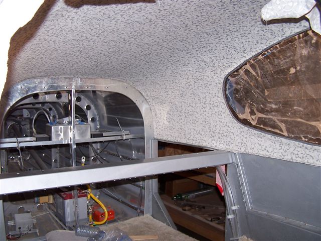

dav1111(at)cox.net Guest
Posted: Tue Jul 18, 2006 3:46 am Post subject: Headliner before cabin cover riveting? |
My wife did our headliner and she used piping around the window frames and
edges. She glued in the piping (covered with the same headliner fabric)
around the windows and then folded the edge under and glued it up next to
the piping.
Russ Daves
N710RV
