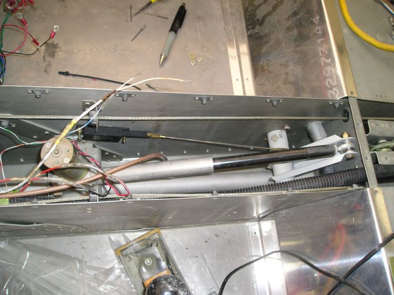

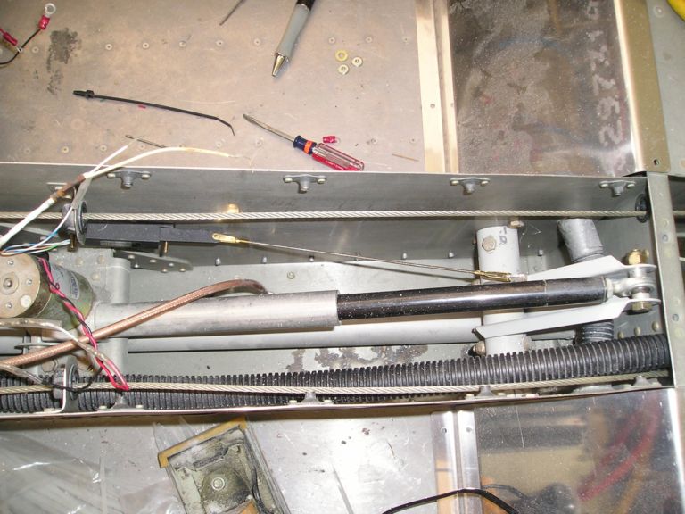

Photos attached of my POS 12 mount. I used 2 pieces of .032 angle, one screwed to the tunnel wall and one pop-riveted to the flap actuator. I connected them with a piece of threated model aircraft pushrod with a brass clevis on one end and a Z bend on the other.
You can also see the flap switch I installed for my Advanced Flight Systems AOA Sport systems.

 Filesize:  55.78 KB
 Viewed:  498 Time(s)
 Filesize:  49.84 KB
 Viewed:  485 Time(s)

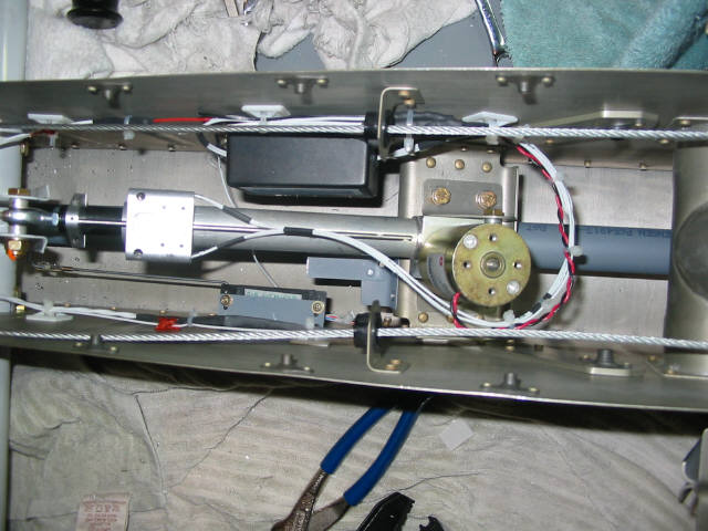

We mounted ours in the tunnel near the flap torque tube.  We attached a bell crank/control horn fabricated from some light AL angle and held onto the torque tube with a pipe clamp so no additional holes were drilled  in the torque tube.  The horn was then linked via 1/4 scale (large) RC aircraft push rod to the 1.2" throw Ray allen potentiometer.  The ray allen potentiometer was mounted on another peice of angle on the side wall of the inside of the tunnel.  You'll have to work the geometry out to get the correct throw on the control horn mounted to the torque tube.  We got about 1/4-1/3" up the horn from the surface of the tube to get the 1.2" of throw for full flap movement.  There's some pics on the website but they aren't very good.  Hope this helps.
Jeremy
http://jharris.net/Aviation/RV_10.htm  if you go about 3/4 down the page, click on the picture of the tunnel.  The sensor and brackets are on the bottom of the pic (starboard side of airplane).
http://jharris.net/Aviation/Flap%20Position%20Sensors.JPG

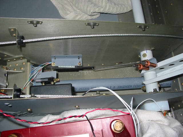

Here is how we've mounted the one in N184JM.
The push rod comes from a remote controlled airplane store.
Grumpy #40404

 Filesize:  73.17 KB
 Viewed:  361 Time(s)
 Filesize:  83.61 KB
 Viewed:  416 Time(s)
