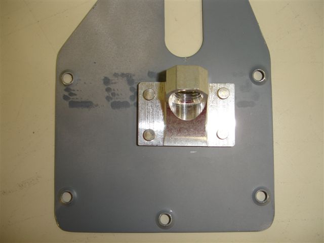

PostPosted: Sun Jan 15, 2006 5:11 pm    Post subject: Re: Trim Tab Cable Anchor Bracket Reply with quote
Scott,
G'Day mate! Dave is working on PayPal. Hopefully, he'll have it up on his web site soon. www.rivethead-aero.com
I enclosed a picture of the bracket riveted onto the trim tab cover plate.
Zack

Trim Tab Cable Anchor Bracket.
 Filesize:  34.84 KB
 Viewed:  1148 Time(s)
