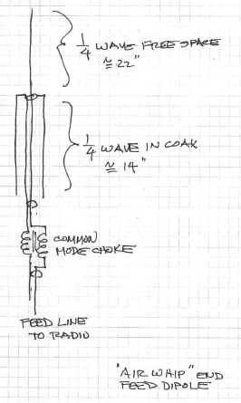

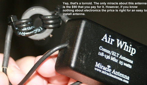

Any 'morphing' of geometry from the center-fed
dipole driven with coax at right angles will
result in a degradation of performance in terms
of pattern and impedance matching. The closest
anyone has come to an elegant end-fed dipole in
the airplanes was the Miracle Antenna brand
"air-whip", end-feed dipole antenna with the
toroidal common mode choke we discussed earlier
this past week.
[img]cid:.0[/img]
[img]cid:.1[/img]
You could string this style antenna out under a
leading edge but you still have to deal with the common-
mode choke 'lump' . . .

The big problem with development of the
lead edge vor antenna is the inconvenient
packaging process that involves cut-n-try
experiments on a device buried under
layers of Fiberglas.
It follows that what ever lies underneath that
layer of glass and epoxy should be a low-risk
configuration . . . it's damned hard to change
if you don't like it.

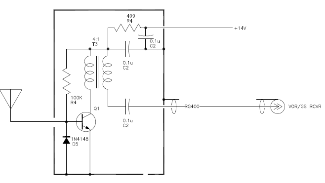

This seems like an ideal application for an active
antenna. This is a relatively short (on the order of
6 to 12 inches long attached to a very compact
amplifier right at the end of the coax feedline.
It takes a little fussing to get dc voltage out
to the amplifier on the coax but this could well
be a VERY compact solution to a receive-only antenna
for VOR that eliminates the geometry issues that
arise when you try to put a center fed dipole into
a leading edge.

I'm thinking about an "active" antenna. An electrically
'short' antenna (less than 1/4 wave) can be an effective
receiving antenna . . . but it's not resonant . . . meaning
that the thing is a pretty hi impedance source of energy
not well suited to piping that energy into a 50-ohm
coax.
A work-around has roots that go WWwaaayyy back in radio
receiving history with earliest practical roots demonstrated
in car radios. Antennas on cars might be little more than
1 meter long yet expected to perform in the capture of
signals having wavelengths in the neighborhood of 200-400
meters.
In the instance before us, it's quite possible to get
a 'resonant' antenna capable of delivering energy into
a 50-ohm coax . . . the problem is physical layout
limits that we've discussed. But suppose we consider a
'short' antenna . . . say about 1/10th wavelength at
115 Mhz or 10" long.
A simple amplifier can be crafted to go on the antenna
end of the coax that will improve the short antenna's
ability to deliver energy into the coax. It takes about
8 components on a board about 1/2 x 3/4 inch. You not
only run your normal RG coax out to this board, you run
a 22AWG wire connected to 14V.
Now your overall antenna is less than a foot long and
doesn't need the "counter-poise" that turns a 1/4
wave monopole into a dipole of twice the length.
I've got some other antenna work to do in the next few
weeks and I thought I would fiddle with an active
antenna amplifier for VOR/LOC/GS. Could you bore a hole
in your canard leading edge foam to accept a 1" piece
of thinwall pvc pipe about 15" long? If so, we may
well be able to craft an antenna that would slip into
the pipe and just lay there.
berkut13(at)berkut13.com

PostPosted: Wed Oct 29, 2014 7:30 am    Post subject: Toroid beads/VOR antenna design Reply with quote
At 18:01 2014-10-28, you wrote:
--> AeroElectric-List message posted by: <berkut13(at)berkut13.com>
A small, active antenna is just fine as I would have room for a circuit board on the end of the whip (inboard end) and have power available a few inches away.
I don’t think I can get 1"dia in there. The D section is quite small in aspect, and there are wooden dowels running fore/aft in the middle of the foam from the construction process.
I'm not sure I have a clear mental image of your configuration.
Q: If the antenna portion of the proposed installation were
a 15-25" long, say stiff rod with the 'amplifier' stuck to
the inboard end, would you be able to install such a device?
It occurs to me that while many builders have described the
boring of a hole through the foam under a composite structure,
it might be possible to simply push the antenna portion of
the device into the foam. The resulting hole would be no
larger than what the antenna itself produced.
In this case, and ideally, the antenna portion would be flexible enough to bend 90degrees (not sharply) to be fed down and into the foam conduit (inboard to outboard) - it is not a direct shot into the conduit from the inboard end.
This is the unclear part. The 'antenna' portion the
system need not be straight, rigid or any particular
shape. It ultimately DOES want to have some geometric
length in the horizontal plane (this is the e-field probe
portion of its physics) but something of a curve or zig-zag
isn't especially detrimental.
So the goal is to get SOME conductor in a mostly horizontal
orientation. The 'active' portion of the installation is
an etched circuit board with a handful of surface mount
components on it. I'm thinking something on the order of
3/4" square. It would be fitted with a length of RG coax
and a 14v power supply wire soldered on. The antenna connection
could be a short pigtail that attached to the end of
the conductor of choice installed in the foam.
[img]cid:.0[/img]
So you know, the antenna will be connected to a Garmin 650 radio that has a VOR/GS splitter internally and has only the one coax connection.
This is a 'broadband' design which should perform
well at both VOR/LOC and GS frequencies. Parts
not already on hand have been ordered. I'm going
to set up a little 'antenna range' experiment in
the back yard in the next few weeks. I can massage
this active antenna project at the same time.
 Filesize:  36.76 KB
 Viewed:  6645 Time(s)
