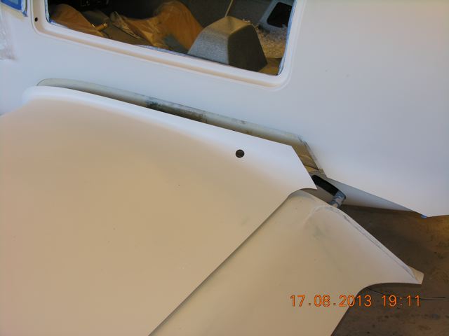

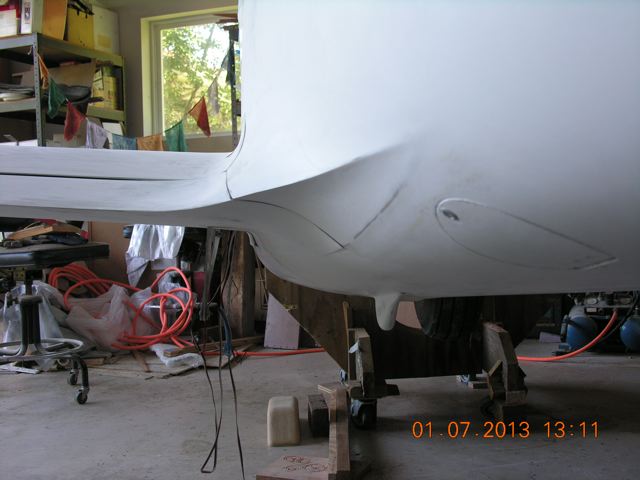

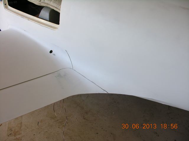

David…your suggestion much appreciated…however, you will note in attached photos that on my ship, the slot gets buried within my enhanced wing root fairings. I fear that the probe will reach interior cockpit / aft fuselage temps. Care to comment on whether my fears are justified?…
Any suggestion (anyone!) for an alternate location…?...

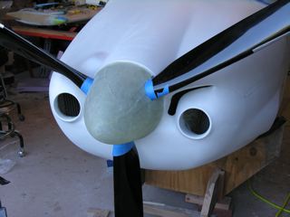

Has anyone place an OAT probe at the front of the cowl, recessed within an opening to keep it out of the sun, and where it would not be subject to engine heat?…say somewhere in the slot opening above my port circular inlet for port radiator?…(we’re looking at a liquid cooled engine installation).
Fred.
[img]cid:0E1C545B-73F5-43CB-8B64-361F99D3F996[/img]
 Filesize:  19.13 KB
 Viewed:  12578 Time(s)

Fred, had not appreciated that you have fancy fairings!
However I guess a nearby position through the lower
surface of the fuselage or the fairing on the starboard
side would serve.
Regards, David
justified?…

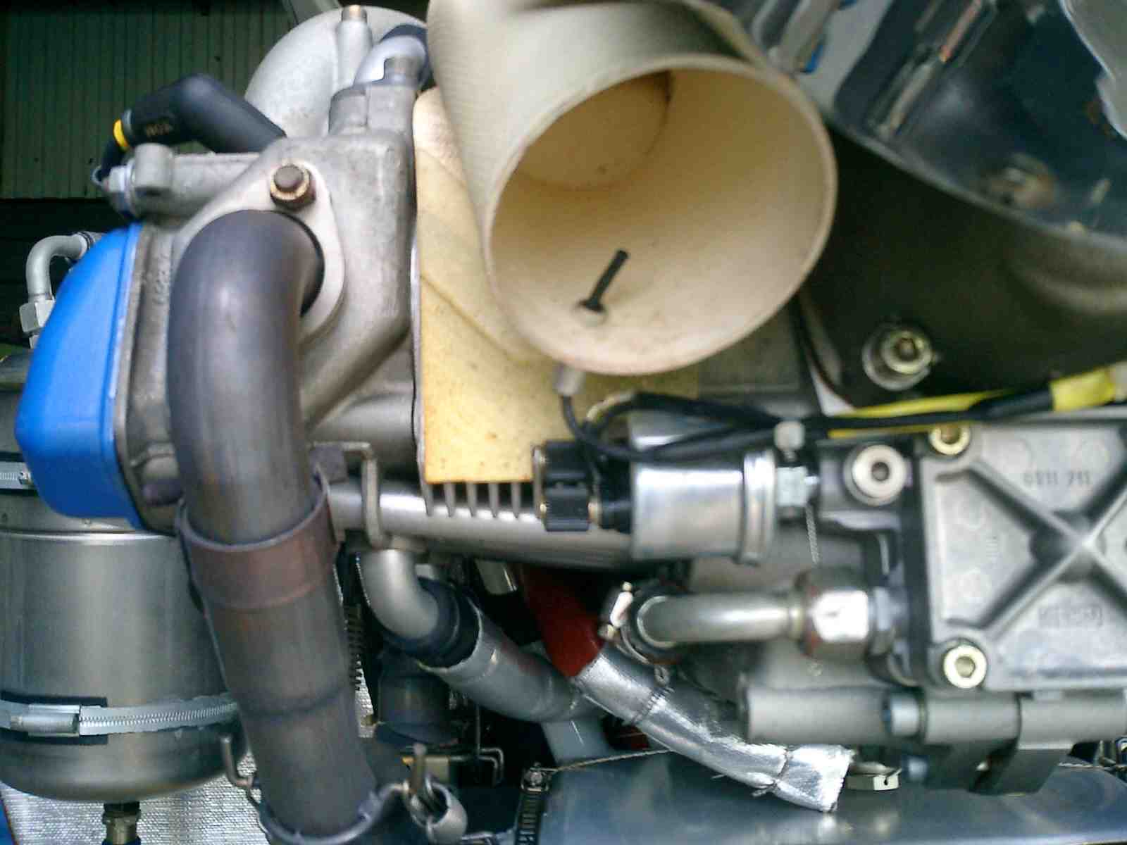

My OAT probe is installed inside the air intake of the Rotax cylinder cooling baffle. Pic attached. It works fine in flight, the measured error being less than one degree C.
However, during ground operation, the indicated temperature is useless as it is greatly influenced by the engine heat.
This works for me.
Remi

Mines installed in the air intake for the radiators and works for me. I certainly don’t see the ram air effect raising the temperature.
Alan

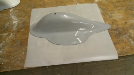

<?xml:namespace prefix="v" /><?xml:namespace prefix="o" /><![endif]--> Fred,
<?xml:namespace prefix="v" /><?xml:namespace prefix="o" /><![endif]--> [img]cid:00eb01cfe177$05a63450$266A5CEF(at)BudsPC[/img][img]cid:00ec01cfe177$05a63450$266A5CEF(at)BudsPC[/img] Photo E-mail View slideshow | Download images That's why its called Custom Flight. We do all this kind of stuff based on the needs and wants of the client. Does it add speed..No. Just costs more time.
While doing the inlet for the teardrop Fred, you might as well add a bit of an extension for it to cover those 525s that stick out. Get it all done at once.
[url=C:\Documents and Settings\Administrator\My Documents\Wheel Pants\IMG_20141006_104202_503.jpg][img]cid:00ed01cfe177$05a63450$266A5CEF(at)BudsPC[/img][/url]
Bud

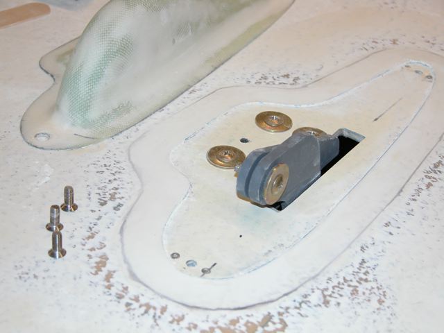

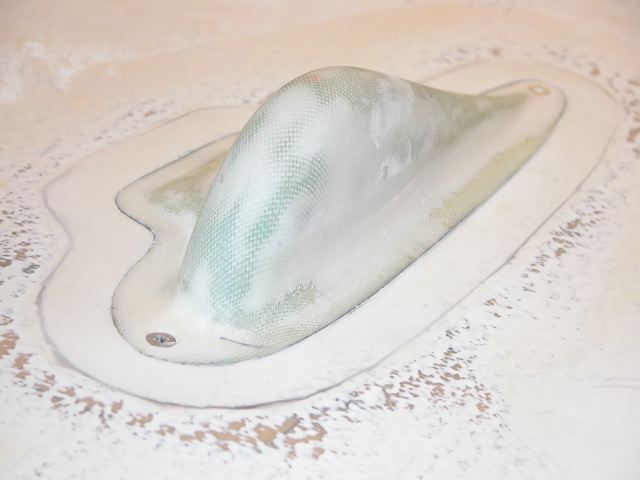

Bud…those look terrific…I had no idea you made them up…as for “time cost”, tis in the mind of the builder!
They look very similar to mine, courtesy of Kingsley Hurst…pix below.
Thanks again for the tip of placing my OAT within.
Cheers,
Fred
[img]cid:D3689CA3-E04B-45EA-819E-61FAE94E6514[/img]
[img]cid:9B5D1330-86FA-43A6-BCC4-1046C19FACE3[/img]
