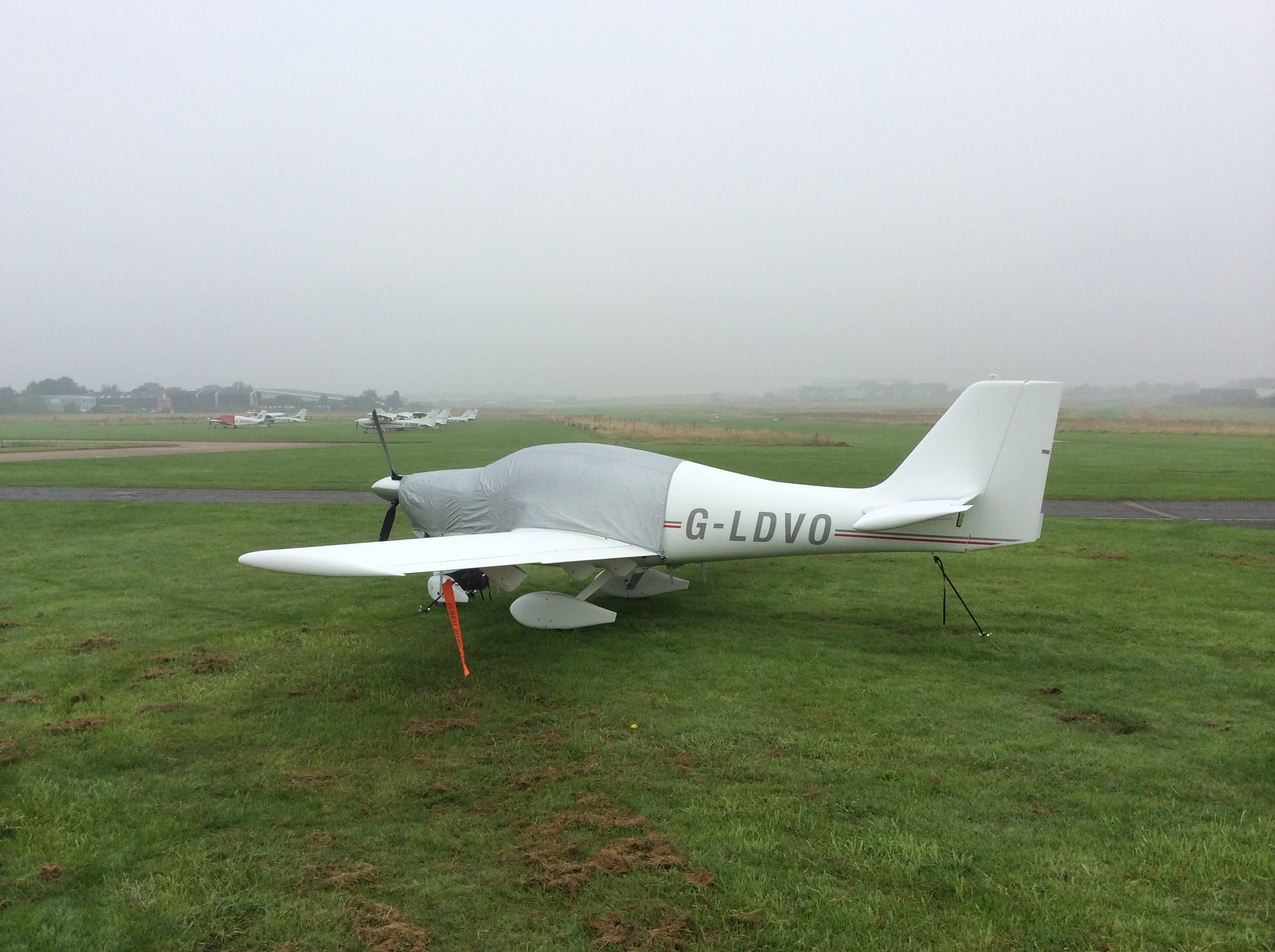

PostPosted: Fri Sep 26, 2014 2:11 pm    Post subject: Ultimate Ventilator Reply with quote
I have something like you describe in my Europa G-LDVO and find them a simple and effective solution. Have flown through some rain and no problem.
When parked outside the pic shows the cover over the vent in front of the door.
Regards Dave Park (PS. Pic shows me stuck in Rochester on way to Texel with fog)

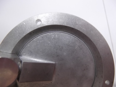

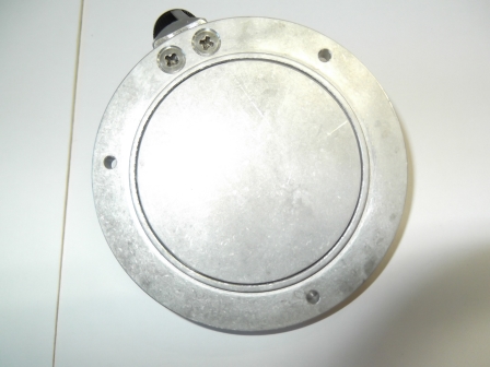

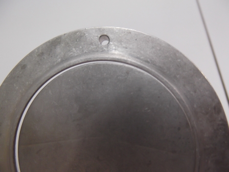

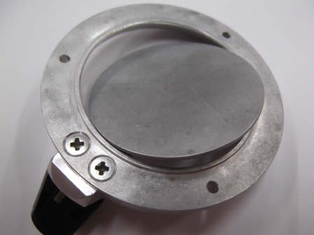

Kelvin Weston
Joined: 14 Apr 2010
Posts: 90
Location: Hampshire, UK
PostPosted: Sun Sep 28, 2014 10:47 am    Post subject: Re: Ultimate Ventilator Reply with quote
Hi Jim
The gap is very small. Hopefully, when painted it should be almost a touch fit when closed.
Pictures attached.
