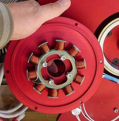

Tom's alternator isn't anything like you'd
find on a Cessna . . .
[img]cid:7.1.0.9.0.20140921180034.01f97ff0(at)aeroelectric.com.0[/img]
It's a permanent magnet alternator with windings
that look something like this . . .
 Filesize:  104.57 KB
 Viewed:  21974 Time(s)

The picture I posted for the PM alternator stator was
and exemplar NEW device. I think the stator that
started this thread was toast. They're not hard to rewind
as long as care is taken to insure insulation integrity
between windings and the stator core. Hopefully his
original core was powder coated and not damaged.

the poles slightly since they are square and quite sharp on the edge. Then
cover the stator in kapton tape. Then use two strands of 16 gauge to wind
19 turns on each pole (total of 2x19=3Cool which is what is there now.
Does anyone have a better idea??
Tom
PostPosted: Sat Sep 27, 2014 11:33 am    Post subject: Stator Reply with quote
At 11:14 2014-09-27, you wrote:
<tkondrat(at)roadrunner.com>
Has anyone actually rewound a stator? My plan is to chamfer the edges of
Sounds good. The chamfer doesn't need to be
much more than to 'break' the sharp corner.
The Kapton is probably good. I've also seen
multiple layers (like 10 or so) of the Teflon
thread tape as an insulation between wires
and laminations.
Your present winding is bi-filar? Connected
in series or parallel?
Eric M. Jones

I've also seen multiple layers (like 10 or so) of the Teflon
thread tape as an insulation between wires and laminations. Bob N.
Bob,
That's probably true, but that doesn't make it right. Don't use it.
As for rewinding things, I've rewound a few motors and transformers in my salad days. I've even had to rewind the same Volvo wiper motor twice...it's a learning process. I even used an old record player to wind 10,000 turns of hair-thin wire on an early audio transformer. You can do well at this with the right materials and advice. And I wouldn't be surprised if you find someone to do it for you for short money.
Eric M. Jones
www.PerihelionDesign.com
113 Brentwood Drive
Southbridge, MA 01550
(508) 764-2072
emjones(at)charter.net
PostPosted: Sun Sep 28, 2014 7:19 am    Post subject: Stator Reply with quote
Bob,
Can you elaborate?
To be sure, education was never cheap in terms of time
and expense . . . but we're free . . . at least for now
to choose what topics in which we wish to invest our
educational budget.
The List is an opportunity to share lessons learned and
to sift alternatives. The teacher's imperative "Don't
use it" is of little value unless the underlying foundations
are offered as to why.
Until he mentioned what appears to be a bi-fillar
winding, the task was relatively low risk. Now, if
we are to serve the questioner well, we need to
make sure that WE and ultimately HE understands
the significance of two wires laid down together.
