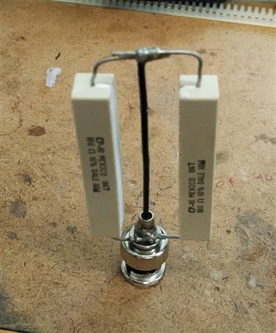

edpav8r(at)yahoo.com
PostPosted: Mon Jul 21, 2014 5:10 pm    Post subject: Transmitting with no antenna? Reply with quote
Alternatively, you could build this dummy load: http://bit.ly/1wSMtI1
..using 20 of these (buy 25 for the price break): http://bit.ly/1lnVgfM
Note: Do *not* substitute wire-wound resistors!
Eric

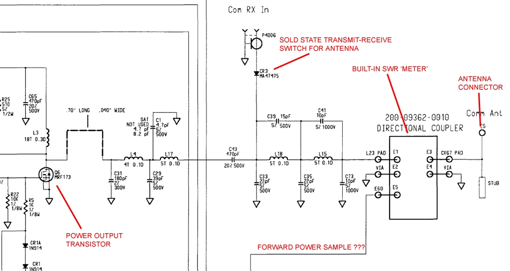

Just for grins, I got a copy of the KX165 transceiver
service manual to bone up on contemporary design
philosophies. Got an interesting surprise.
Here is an excerpt from the transmitter schematic . . .
Yup . . . there it is . . . the expected directional
coupler. But when I read the accompanying text, I was
informed that the directional coupler output was
used to sample FORWARD power for the purpose of leveling
the transmitter's output power. No mention was made
for 'high SWR protection' . . .
In fact, a search of the entire service manual
for "standing" or "SWR" produced no hits. Say
what????
[img]cid:.0[/img]

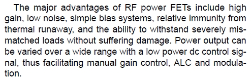

Here are some excerpts from the manufacturer's data sheets
on the KX165 powuer output transistor.
[img]cid:.0[/img]
This is a MOSFET rated at 80W of output in VHF operation.
Further we read the following . . .
[img]cid:.1[/img]
Down in the tabulation of characteristics we also
find . . .
[img]cid:.2[/img]
I was pleased to find that my original assertion was
correct but for the wrong reasons. It seems the MOSFET is
immune to damage from the stresses that would have
shot its ancestors out of the saddle. Hence no wrap-around
protection was needed. The directional coupler was still
there but pressed into service other than output
stage protection.
Another interesting feature from the schematic excerpt:
Notice the "stub" depiction on the antenna output line.
A search of the manual doesn't speak to its existence
or purpose. Given that this is a deign from the hallowed
halls of the Nav/Comm gods, I suspect that 'stub' is an
shunt filter element tuned to reject transmitter harmonics
that fall on or close to GPS frequencies. Garmin used to
offer a 330-00067-00 Notch Filter intended to be 'scabbed
on' to the nav/comm antenna connector.

Using the logic of "if some is good, more must be better", I picked up some 10w, 100ohm resistors. Smile
Checked with the manufacture (Val) and they said that I'm probably okay:

PostPosted: Tue Jul 22, 2014 4:28 pm    Post subject: Transmitting with no antenna? Reply with quote
Don,
Just be sure the resistors you sourced are not wire-wound types. At a 10W rating, most are. These are inductive and will make a very poor dummy load.
Examples to avoid: http://bit.ly/1A3zd7U -or- http://bit.ly/1rImumj
Bob's 2W-10W dummy load appears to be built with Metal Film or Metal Oxide resistors.
Eric
donjohnston
Joined: 13 Dec 2009
Posts: 232
PostPosted: Wed Jul 23, 2014 6:05 am    Post subject: Re: Transmitting with no antenna? Reply with quote
edpav8r(at)yahoo.com wrote:
Don,
Eric
Yep... They're wire wound.
I can't get anything right lately. Sad
PostPosted: Wed Jul 23, 2014 6:54 am    Post subject: Transmitting with no antenna? Reply with quote

Uh... Val didn't say I would be fine with 10W resistors.
They said that the radios should be fine.
In regards to circuit protection, the COM 2KR doesn't have any active protection against keying the unit without a proper load attached. As such, you run a small risk of damaging your radios keying them up without an antenna. However, the radios are resistant to damage from being keyed without an antenna and should be fine.
I'm going to redo with the 1W metal oxide resistors. I'm only tracking down an audio panel switching issue. As such, I'm only keying the mic long enough to see if I get a transmit indicator on the display. So about a half second whenever I hit the PTT.
