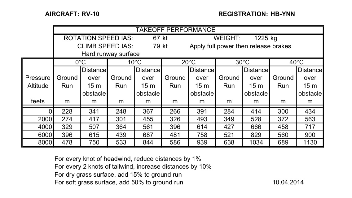

I attached my T/O table based on my T/O performance test. Please note that max RPM is reduced to 2500 due to noise regulation here in CH. Aircraft was at MTOW 2700 lbs / 1225 kg. take-off configuration flaps 1 = 0 degrees.

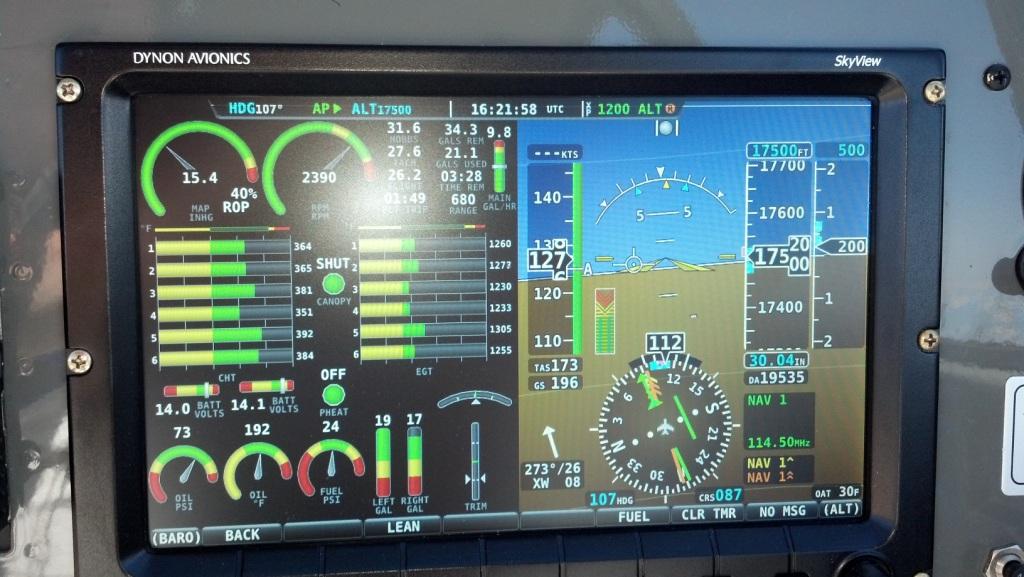

17.5K in mine. Photo taken just after leveling off. This was during the 40 hour test phase – so solo (light).

I had mine up to 17,000 this weekend twice to get over some cloud build ups coming back from OR to WI. I was no where near gross but it made it up there with ease.

20,100 with rate of climb of 100’ a minute.  Gross weight of 2800 at takeoff, CG on the aft edge and a little beyond.  Done during testing to determine service ceiling
IFR flight between Ogden Utah and Las Vegas with just me and my wife…plus bags… 19,000.  My wife does not like to fly in the clouds……O2 mask is a pain…..

We have hit 22,000 close to gross, but it sure didn't like it up there. Over 18,000 the climb us terrible and the IAS is approaching stall.

I am curious what the highest altitude anyone has taken their -10 up to?

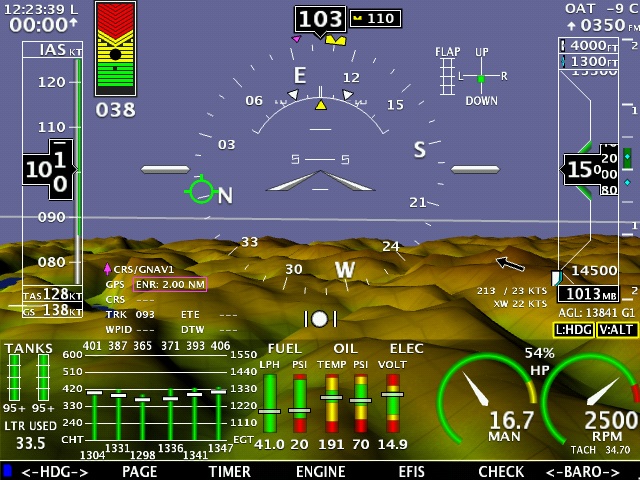

16,500 with the family fully loaded....but it didn't climb very well.
I'm sure we could have made it higher, but I don't find much point
in going over 14K very much. It starts to become work again.
We don't carry O2 on all flights. I kind of missed it on the one
we just got back from though (write-up coming within 24 hours).
The problem (in my mind at least) with using 16-17k+ to stay above
the weather is that you don't have any performance margin left.
If you're plenty happy to be stuck back into the CB's, then fine,
but if you really want to stay "on top", you have already pushed
into the area where performance of the plane may not give you
much room. To each their own, but I just find it to be more
work as you pass 14K.

Here you go! During my climb performance test. I had to stop at 15k due to airspace clearance. OAT -9C at MTOW 2700lbs still climbing with 350ft/min at Vy. CHT gets quite high though.
Mike
