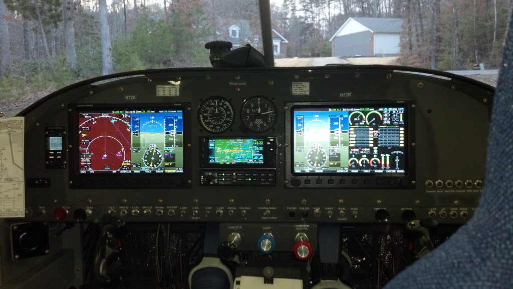

Rick,
I did not like the alt air location, but I did like the standard Throttle, Prop and Mixture placement. I made a new bracket out of .050 aluminum and spread out the three controls just a little. The Oil Cooler air control (black knob) and Alt Engine Air control (red knob) are located on the left side of the apron. The two cabin heat controls (black knobs) are on the right (didn’t want the passenger to pull the alt air by mistake. Photo attached. Cable firewall holes are generally in line with the control mounting. If I was to do it over I would move the two cabin heat controls a little further to the right.
I also added a single .063” piece of angle connected to the bottom apron near the engine controls and the firewall. I was concerned there was too much flex in the middle of the panel. Might be overkill.
I did find the throttle cable Van’s recommends (47.5”) to be too short. I sent it back to Van’s and got the one he lists for IO-360 (50.5”). This is about an inch too long, but easily routed to make up the difference. The stock cable was tight against the bottom of the engine (IO-540 from Van’s).
Carl

PostPosted: Fri May 23, 2014 10:26 am    Post subject: FirePenetrations Reply with quote
Thx Carl.  I am presently fabricating stainless steel penetrations for my F/W and thought about ganging the throttle, prop and mixture together on a piece of 3"x4"x1/16" SS plate, basically in the same location as the pilot holes are.
I think I will wait to drill the alt air.
Nice looking panel, quite similar to what mine will look like (except it's a G3X touch).
Is the panel powder coated satin black or?
Thx again,  Rick

PostPosted: Fri May 23, 2014 11:27 am    Post subject: FirePenetrations Reply with quote
I lot of people ask me where I got the panel powder coated – but it is just PPG single stage paint.  Dark gray for the panel and engine plenum, light gray for the rest of the interior.
The is the second panel.  As with my RV-8A I find there is always something to change on the panel every few years or so.  Using the stock Van’s panel with paint make panel mods relatively simple.
