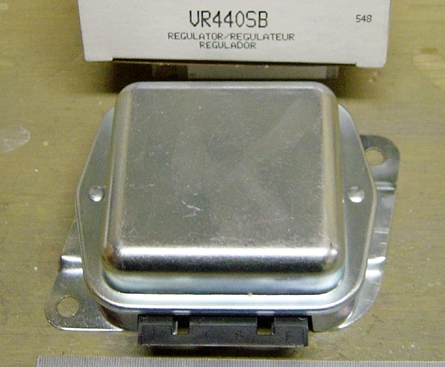

Yup . . . airplane parts business suffers
from the same malady . . . no part number
no part . . . assuming it's even in the system.
That's one regulator that has a 99% chance
of being 'correct' by simply observing it's
shape. If it looks like this
[img]cid:.0[/img]
It's going to work.
Here's an array of options from a local US
supplier. Used 1980 Ford Fairmont as baseline
but if you look at other models over 1975-1990
model years, you find a similar array.
http://tinyurl.com/m7ke8p2
other examples:
http://tinyurl.com/od994zl
http://tinyurl.com/l6qm8js
http://tinyurl.com/m83q5q8
http://tinyurl.com/lro7dlh
Poke around on the 'net long enough and you'll
find this part offered on a dozen or more part numbers.
You should be able to pick one up for about $20-30 . . .
perhaps less.
