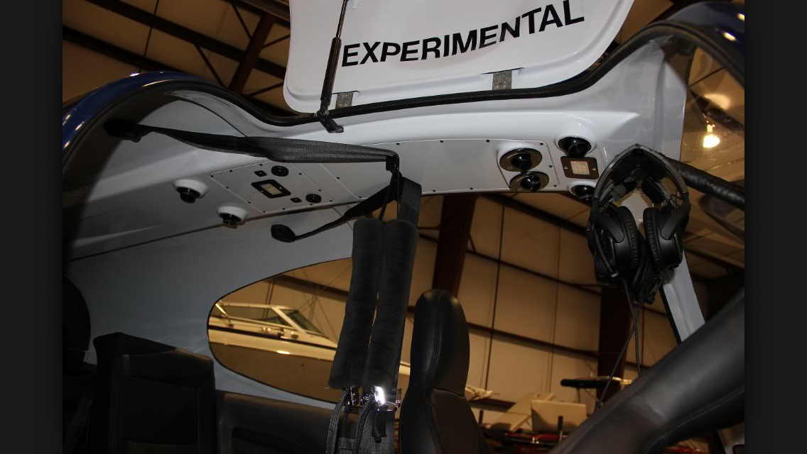

carl.froehlich(at)verizon
PostPosted: Fri May 09, 2014 4:57 am    Post subject: Gap at the cabin door hinges Reply with quote
This is what I did. It provides a good seal. I had some rigid foam laying
around to shape and fill in the hinge void, then the simple McMaster self
adhesive seal goes on top.
Carl

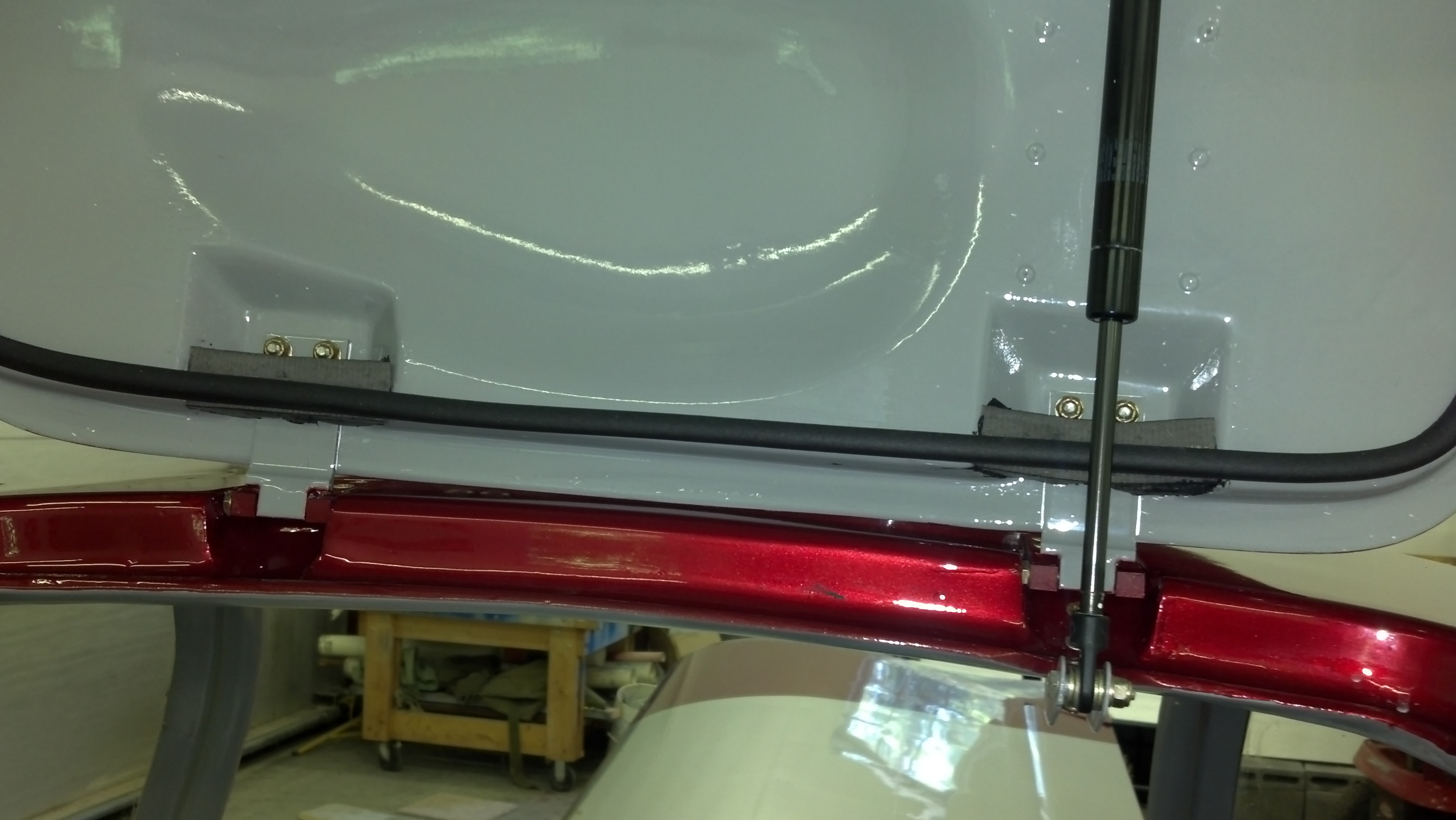

PostPosted: Fri May 09, 2014 4:57 am    Post subject: Re: Gap at the cabin door hinges Reply with quote
I hand fit four .032" plates, prosealed them in, painted with inside of doors. Hardware still accessible and water/air-tight.
Wayne G.
sean(at)braunandco.com
PostPosted: Fri May 09, 2014 5:11 am    Post subject: Gap at the cabin door hinges Reply with quote
 Filesize:  816.87 KB
 Viewed:  5904 Time(s)

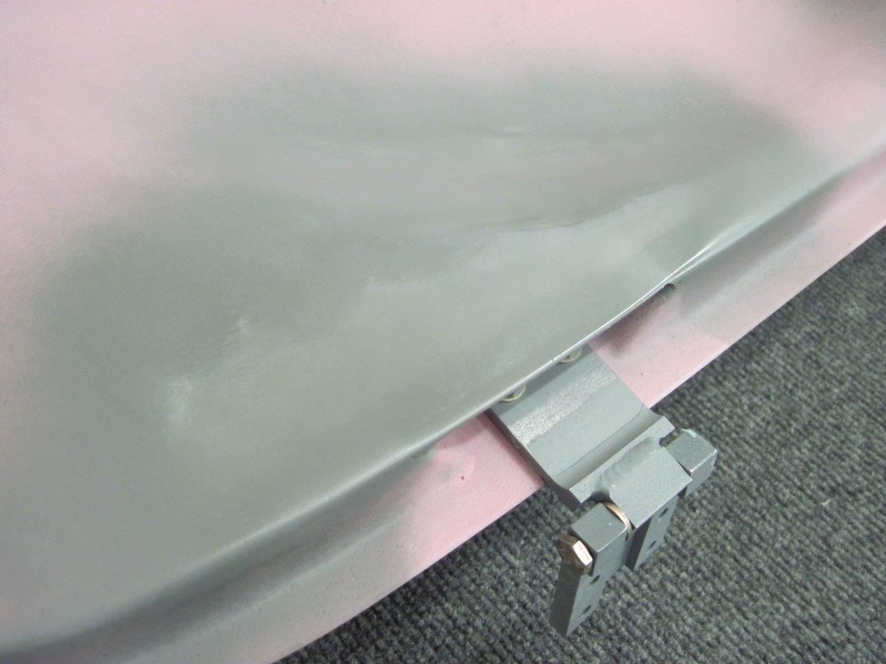

PostPosted: Sat May 10, 2014 11:14 am    Post subject: Re: Gap at the cabin door hinges Reply with quote
I used a scrap piece of the window cutout FG to create a small piece to fit over the gap. I glued it in place with resin and micro. Did the body work on the outside with resin stranded body filler.
 Filesize:  110.66 KB
 Viewed:  5856 Time(s)
Bill
