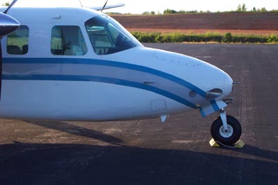

n395v
Posts: 450
PostPosted: Mon Jan 16, 2006 5:43 am    Post subject: Re: Shrike nose Reply with quote
I must be in the minority prefering the snub-nose of the older Commanders
Nope. I suspect most of us prefer that classic buxom look. Very Happy
N295V
 Filesize:  32.99 KB
 Viewed:  2550 Time(s)
Milt
