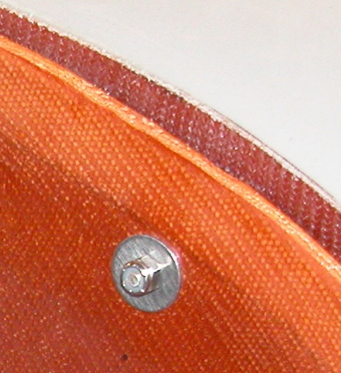

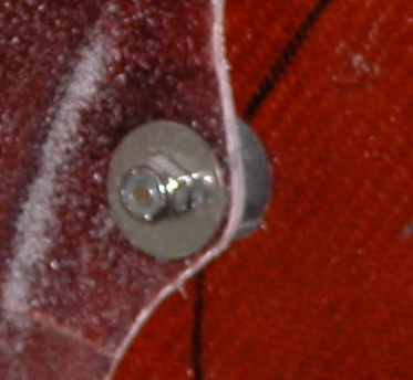

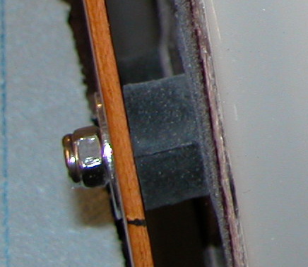

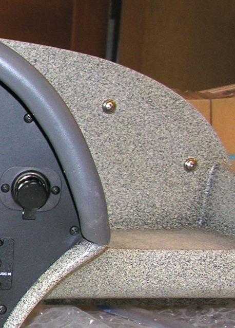

Tony…to get the benefit of vibration isolation, the SS 1/4” dia. McMaster-Carr vibration damping sandwich mounts do the trick…much better IMO than any kind of a thru bolt...see cat. pg.:
http://www.mcmaster.com/#vibration-damping-sandwich-mounts/=r882gh
...photo below shows the male threaded stud each side, and there is also a male / female style, 3 of which I used on the picnic tray STBD side along w/ SS machine screws and finish washers.
I found the 1/2” long studs to be just long enough to penetrate the firewall and to have room for a washer and stiff nut. Although a stickler will notice that I lack the requisite visible threads beyond the face of the nut, I do not consider that to be critical in this instance.
Fred
