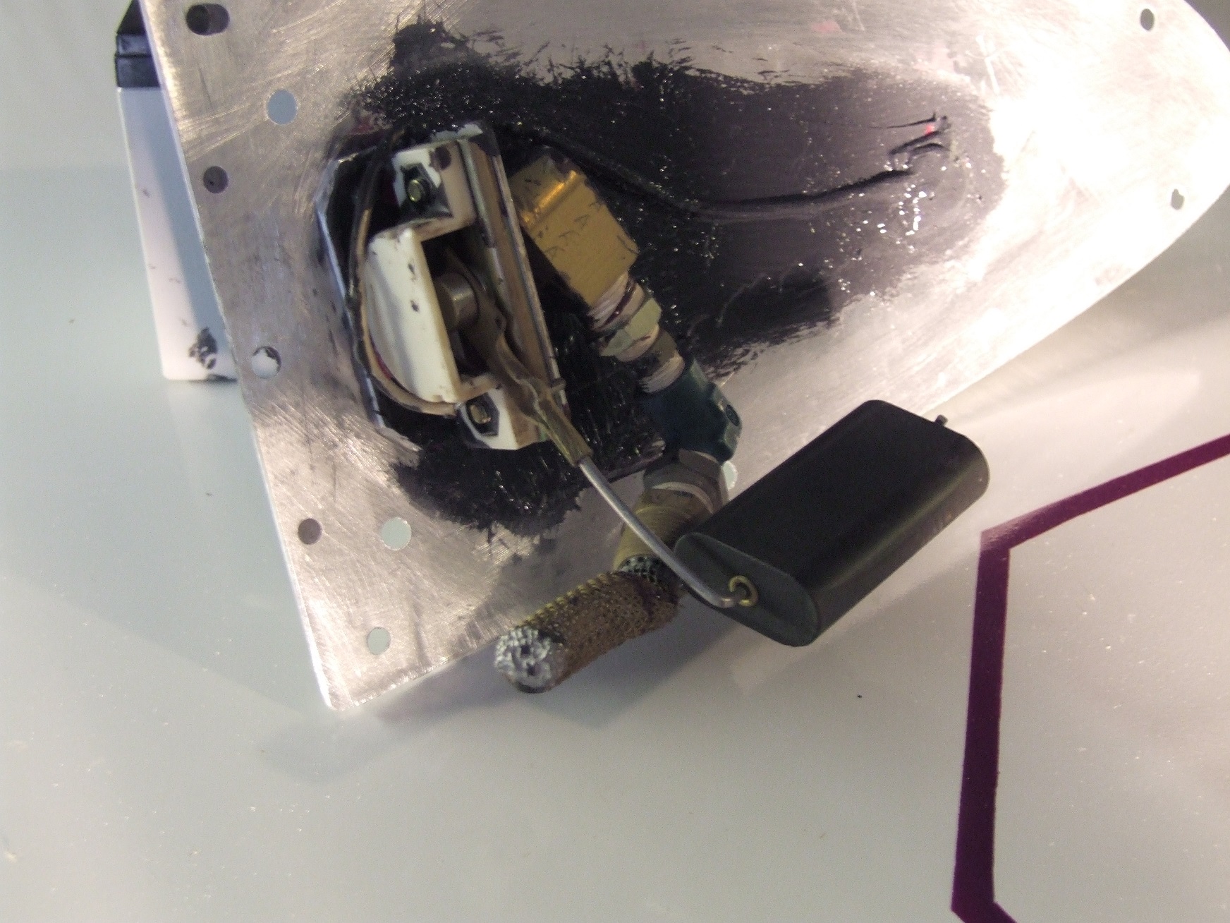

I installed some resistance style senders that I think I got from AS&S many years ago. I reduced the arm length to make better use of the entire resistance track so that I get ‘full’ and ‘empty’ on the fuel gauge. Of course, they don’t read the top couple of gallons in the tank, but I’m not concerned that that fraction, it’s the last gallon or two that I am worried about! Mine read accurately all the way down to the last half gallon. Photo attached. These have worked well for the last 18 years or so.
Barry
