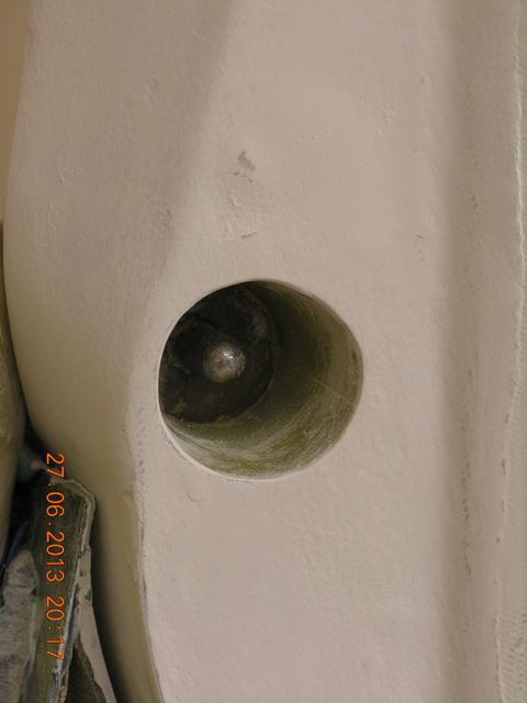

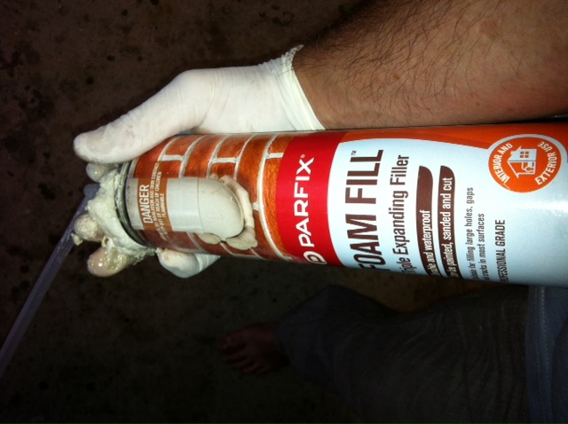

Gidday,
Like others I am considering whether I will close off the end of my flaps. I have found a tube that is tapered down to the OD of the flap cross tube, my vacuum cleaner wand, and I have created a couple of tubes that I intend on placing over the flap cross tube and re-rigging the wings, then filling the gap ideally with expand foam or something similar, shaping it, and then glassing over it, with flox corners and 2 plies of BID. Has anyone used expand foam to shape things as it is a deep closeout now with the flap extensions on them, and to make up foam inserts would be a bit of a disaster. I tried some expanding foam today, upside down as instructed, and disaster. It managed to exude around the base of the wand, not down it into my dummy setup, the inside of a tissue box. So, I have a puddle of expanding cell foam on my bench that I can now see if it is sandable and shapeable, or not.
There must be an easier way, but I don’t know what it is. It seems wise to fill it rather than have a chamber of air, requiring venting if I just create a wall at the end of the closeout, somehow. Any tips??
Tony R.

It's hard to tell from your picture, but it looks like you have "tripple" expanding foam.
I have fooled a bit, especially with Foam Radio Controlled models and low expanding foam is the secret. Once cured it trims up very nice with a razor blade or knife.
I used the low expanding foam to support my fuel tank after the cockpit module was installed.
See "Say NO to crack":
http://www.europaowners.org/main.php?g2_itemId=86925
Remember that the flap cross tube articulates as the flap is raised and lowered, in other words the angle it meets up with the flap drive pin changes. You need to take this into account. I have a drawing in my build manual, I think it came about from England, perhaps I downloaded from the Europa club, but it called for building up the OD of the outboard flap tube, perhaps it was somewhere between 1/8" and 1/4" (I'm not exactly sure), then the tapered guide fit reasonably close to that built up OD that would allow you to get the pin engaged, then when you sent it home (pushed the flap all the way on the pin) the tapered guide went away so you now have clearance between the tapered guide and the now normal OD flap drive cross tube.
So many words, my thoughts are now probably clear as mud!:

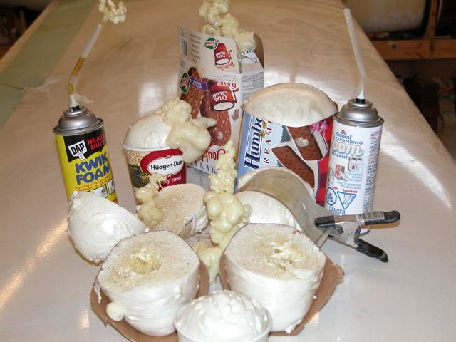

On Feb 19, 2014, at 1:27 AM, Tony Renshaw wrote:
Gidday,Has anyone used expand foam to shape things as it is a deep closeout now with the flap extensions on them,
Tony...yes, I have. I tried and tested many different kinds. I got my best results from "non-expanding" foam...I also found a 3 oz. paper cup to be an easy way to form a tapered guide for the flap pin into the flap cross tube...Fred

Neat and helpful. Assuming all cups are not created equal, where'd you get
the cup from? Smile
Tony,
I used expanding foam on my temporary seat modification Jig, that created a
shape for the carbon-fiber plies to form on. It was of the type that needs
two parts mixed together, and would expand like crazy once mixed. Unlike
from the can, the mix is fairly homogeneous as far as not leaving air voids.
I did notice that some of the cured 'bubbles' were larger in some areas than
others though. There is a lot of power there. As long as the exit hole is
properly sized to let out the pressure during the expanding process, it
seemed to do pretty well in fitting the (closed) form that I created for it
to expand to. It's probably a good idea to let it sit for a few days to be
sure the chemical reaction is halted.
