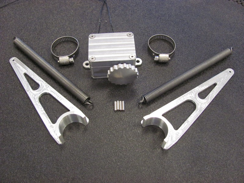

Joined: 07 Nov 2007
Posts: 231
PostPosted: Sun Dec 08, 2013 8:31 am    Post subject: rudder trim RV-10 Reply with quote
John
Aerosport Products rudder trim is a much more refined unit then the
skunkworks.
You get what you pay for with our rudder trim. It might not be for everyone.
If you saw
What goes into making this a quality unit and you may or may not understand.
Geoff
Geoff Combs
Aerosport Products
8090 howe industrial pkwy
canal winchester, ohio 43110
614.834.8659p
www.aerosportproducts.com

PostPosted: Sun Dec 08, 2013 11:14 am    Post subject: rudder trim RV-10 Reply with quote
I love my rudder trim form Aerosport. It works perfect and doesn't add
weight to the rudder assembly. As a great by-product it holds the rudder
from being slammed around in winds. Of course you need to put in a gust
lock in strong gusts.
