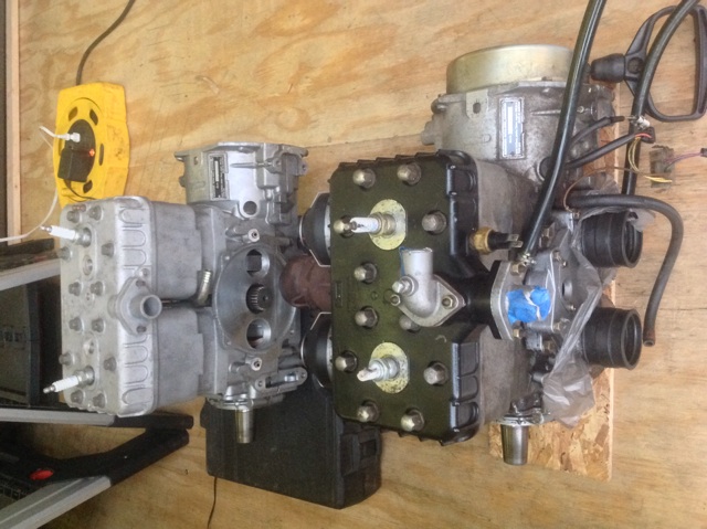

Good luck with your 670 build. I know Rick real well, and I am sure he will
do a good job doing the Machine work for you. I have two 670's myself, but I have decided that a Rotax 618 has plenty of enough ponies for my Firestar II
The 618 I have needs to be rebuilt and I plan on having Rick do the work for me. I was real lucky this summer to find a Brand New 618 exhaust on E-Bay, it has never been used. I also plan on letting Rick doing a 670 for me as I plan to have a Two Place side by side one day. Hopefully it will be a Mark III Extra
or a stretched avid flyer.
Anyway keep us informed on your Progress

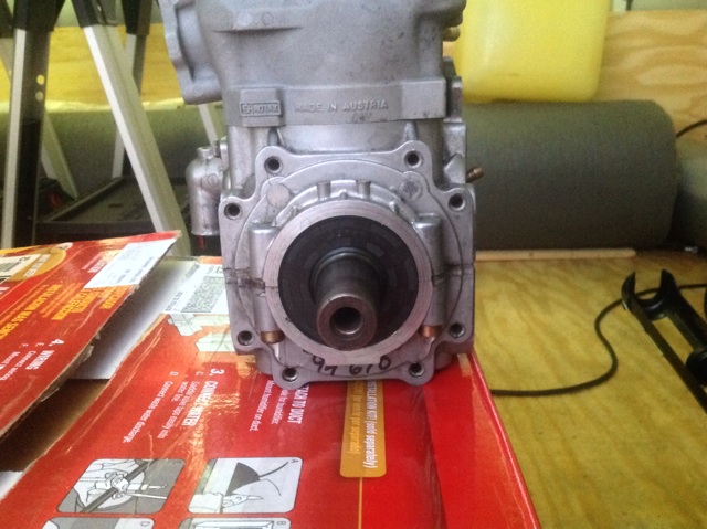

Just some info that some may not know. All 670's that Rotax made are not a good candidate's to be converted for aviation use. That is if you want Dual Ignition. and some are not easily made to be provision 8. Their are 2 years that are preferred the 93 and 94 model year. If the 670 has a black rubber cover on the Mag end then you will not be able to have it become Dual Ignition
Many people think that Rotax was planning on making the 670 into an aviation engine like they did with the 617 that became a 618. If they did it would have been competition for the 912.
here is a picture of the early model PTO end, that can be made to accept a
c-box or e-box. you could even use a b-box but I think it would not hold up to all the extra HP
