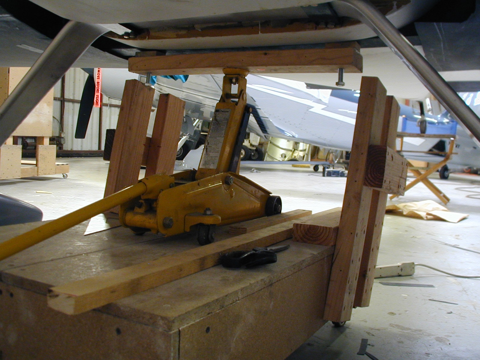

Here is a picture of the wing removal tool I built. It has 4x4s at the corners and is on wheels. The vertical 2x4s should be vertical and not angled like the picture. The wing drops out of the fuselage and slips between the 2x4s before it comes out of the fuselage so the wing is always supported.  It is also really nice to have the wing on wheels.
It makes it a one man job and pretty low stress. The wing probably went on with the gear on so it should come off.
Scott

All I can say is that picture makes me want a Yak.
And I love your tail wheel stand.
And your wing tool is very cool. I think I will be making one.

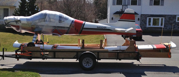

Thanks guys for the information. I just purchased a TR-1 and i am going to get it this weekend. Need to transport it home as it is not currently airworthy. That will make it much easier not having to remove the gear. I also have seen where some people have had some of the wing spar bolts seized as well. Hopefully this is not the case. This plane has been out in the weather for about 9 years though.

Congratulations on your purchase and welcome to the fraternity. Without a question you got the best bang for your buck despite any problems you may encounter. On this forum are plenty of qualified individuals that can help you with any need.
You might want to be packing a Sawzall just in case the main spar bolts are seized in place. There should be just enough room to get the blade between the spar and the fuselage spar box. The penalty would be the loss of the aluminum flanged bushings in the spar box (the bushing on the nut side should be removable if not gluded in place), but those parts should be available from Lyle Hendricks. You’ll need to disconnect the aileron push tubes from the bell cranks to side the tubes out of the fuselage. This past spring I moved my TR-1C 1200 miles from Minnesota to Philadelphia, PA, I did not realize the push tubes were disconnected as the wing was off when I arrived to pick up the airplane. I checked the airplane at each fuel stop but on the last run over the PA mountains one push tube slid out and I almost lost it but it got wedged in place by one of the wing supports. I used the spar bolts as the main attach point along with the wheel axles and the tail wheel to hold it on the trailer. My advices is don’t buy that cheap duct tape from Harbor Freight it sucks.
Robert Reeds website has a complete TR-1 builders manual if you do not have one. http://www.kisbuild.r-a-reed-assoc.com/
Good Luck,
Mark T. Pic attached of my arrival at home

Hey Barry,
Jerry is referring to the 6 X 6 access panels on the outboard underside of each
wing located over the aileron bell crank. The left wing should also have the
pilot static ports attached to it. These panels are cut into the wing skins by
the builder and have 4 screws in the corners of each panel. There were supposed
to be nut plates attached to the inner fiberglass layer of the laminated wing
skin in each corner to secure the panel to the wing. Not all builders used
nut plates, my build used plain sheet metal screws and they just do not hold up.
I believe Jerry is saying the panel may be glued in place. You may want to
pack two more tools  a Dremel with those little gridding discs and possibly a
few other cutting attachments, and if that dont work a jig saw to cut out the
whole panel. Heck, its fiberglass and easy to patch up or fabricate a new one,
but dont cut to close to the corners where the nut plates are supposed to be
just in case they may actually be there. You wont want to be wasting too much
time getting the cover panels off youll have you hands full getting the wing off
and the plane loaded. It took me 4 hours to set up my trailer rigging and get
the plane loaded and that was 2 hours more than I thought it would take.
There are other fairings on the bottom side of the fuselage you will need to remove.
One covering the spar box opening. Two small removable  leading edge fairings
on underside of the wing. Two larger fairings that contour the wing to the
fuselage. These should all have nut plates used to attach them but may also
have sheet metal screws in place. If they are nut plate and corrosion has set
in getting those screws out can be difficult. If the heads become stripped out
the Dremel and thin griding disc deal is great to cut larger slots in the head
for easier removal.
