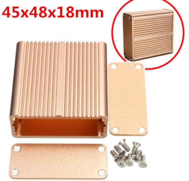

You guys might be thinking about how you'd like to
configure the 'elegant' package. The ECB I've
crafted will lend itself to either an open-
to-the-sky style of installation, like our
old AEC9005 . . .
[img]cid:7.1.0.9.0.20170711182114.06b813d8(at)aeroelectric.com.0[/img]
of course, this can be put into some form
of enclosure with the connector extending
through the wall.
There's a kinda cute extruded aluminum
enclosure offered from several sites on
the 'net . . .
[img]cid:7.1.0.9.0.20170711182114.06b813d8(at)aeroelectric.com.1[/img]
The final configuration could be converted to surface
mount components. Connections brought out on flying
leads through a grommet.
The advantages for thru-hole components is that
more people might be encouraged to take on
the project. Anyone spotted another option?

I guess with the through-hole PCB layout done and ordered, there's probably little point in me continuing my effort to do it here. I'll lay down my pencil unless there's another way I can assist.
Let's see how the
If it's decided to pursue a surface mount version, I'd be happy to work on that. Just say the word...
The board I have is about 2x the area that
would be required for SM components . . . and
if I were tooling up to build quantities, I'd
go SM. But if we're wanting to maximize penetration
into the DIY community, TH is probably better.
Once the hardware and software are successfully
married, an SM version in the smaller extruded
aluminum enclosure might encourage someone to
build up small quantities for sale . . . to
be sure, the plug-n-play community is larger than
the DIY community.
B&C might be intreseted in adding it to their
stable of products . . . let's see how the
project matures.

  fancy . . .
http://tinyurl.com/y8j6qrva
  Unless the builder has programming capability for
  the PIC chip, I'll suggest the chip not be ordered
  from Digikey rather from someone in the project group
  with programming tools.
  I think the mechanical aspects of the data package are
  now complete. I'll assemble one here as well so we can
  beta-test software and compare notes.

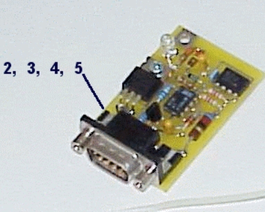

PostPosted: Fri Jul 21, 2017 8:18 am    Post subject: IVO Prop current limiter Reply with quote
Got the board stuffed.
http://tinyurl.com/ycemckye
I need to get my pic programmer up and running
for a couple other programs. I'll pop a 9023 chip
and see how critter works.
