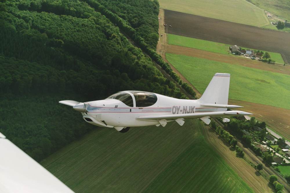

BTW I'm not the only one who devised something like this. See the
attached picture. This is another configuration with a thin radiator in
a 45 degree angle, although it lacks a cowl flap and heat exchanger for
the oil. (Oil is cooled by a radiator, fed by a NASA duct on the port
side, you can see it on the picture). Also this owner claims very good
results with his setup on his 914 engine. The key really is to use a
thin radiator and mount it at the belly so the "used" air can take the
heat of the exhaust with it, and enjoy the benefits of a very sleek
cowling, excellent cooling, low pressure losses, and minimal cooling drag.

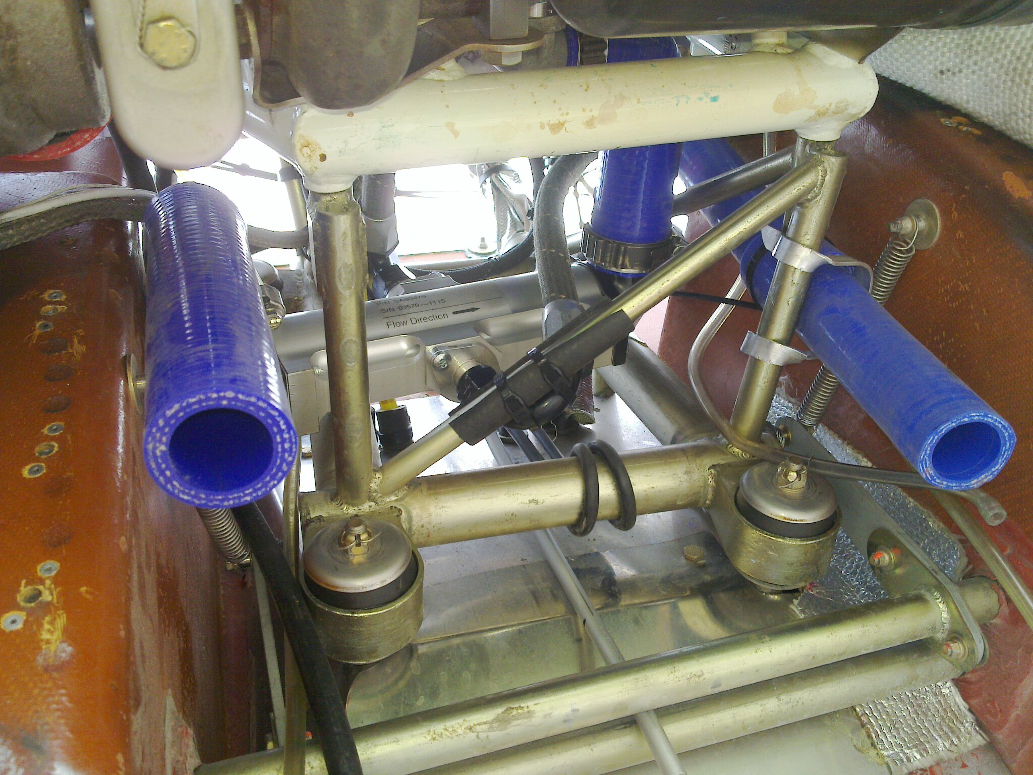

See picture, taken from under the engine. The heat exchanger is mounted
behind the engine. This was the first setup, with the stock coolant
radiator, hence the configuration of the coolant hoses pointing
downwards. In the current design the hose routing has been changed to
accomodate for the thin belly radiator.
If you really want to go this way, contact me privately for more info.
One caveat though: this heat exchanger has very thin canals and is not
compatible with Evans coolant due to its viscosity. I use it with 50/50
without problems.

Hi Frans,
I'm a bit puzzle by your first picture: are the blue pipes directly
connected to that flat radiator? I think these end at the bottom level of
the exhaust, so what is the shape of the radiator...
cowlng, excellent cooling, low pressure losses, and minimal cooling drag.
without problems.
>this. See the
>thin radiator in
>heat exchanger for
>duct on the port
>claims very good
>is to use a
>air can take the
>very sleek
>stock coolant
>pointing
>been changed to
>for more info.
>canals and is not
>use it with 50/50
> without problems.
As I wrote, this picture was taken when I was still using the stock
radiator. The hose routing has been changed when I upgraded to the flat
radiator. Actually I now use aluminium pipes for the coolant for most of
the routing, because of the close proximity of the exhaust.
Other question: have you experienced (or do you think there is) differences
on that topic between 914 and 912?
I have no 912, but as far as I know the 914 is the most difficult engine
to cool, so if it works on a 914 it should work well on a 912.
