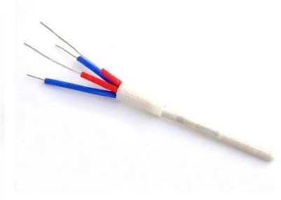

PostPosted: Mon Feb 20, 2017 11:08 am    Post subject: Solder Station Reply with quote
At 07:42 PM 2/19/2017, you wrote:
--> AeroElectric-List message posted by: Alec Myers <alec(at)alecmyers.com>
My bad - it's not the Curie point. anyone know the physical effect that Metcal irons use?
Some form of thermo-sensor at the tip.
The cord out to the tip is multiple
conductors. Replacement heaters
have 4 conductors.

My Weller solder station uses a magnet attached to the back end of the
solder tip. It loses magnetism at the predefined temperature as it
heats. That cycles the power to the heater. It is often referred to as
the Curie temperature of the magnet according to Wiki. You can change
tips for a different temperature.

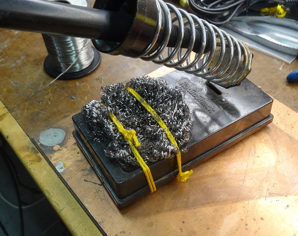

PostPosted: Mon Feb 20, 2017 11:56 am    Post subject: Solder Station Reply with quote
We must have different MetCal soldering irons, then. My handset is connected via an RF connector and a length of heat-resistant coax.The station is a 50Watt 1MHz (I think) RF generator, and the tip selectively absorbs more RF energy as the temperature drops, and yes, it was the Curie point effect that's used.
[img]cid:0BCDED1D-CC43-481D-B301-0A4A496B99F3(at)lan[/img]
The base station and handset is about USD$1k - but, it's a complete pleasure to use, from the tiniest SMD component to soldering ring terminals on 6, 4 or 2 gauge wire - all equally easy.

Interesting point of comparison: the expensive Metcal station is still only 70% of the list price of the AMP crimp tool Bob has been recommending.
On Feb 20, 2017, at 3:49 PM, Stein Bruch <stein(at)steinair.com (stein(at)steinair.com)> wrote:
v\:* {behavior:url(#default#VML);} o\:* {behavior:url(#default#VML);} w\:* {behavior:url(#default#VML);} .shape {behavior:url(#default#VML);} <![endif]--> <![endif]--> <![endif]-->
The older Metal’s use the multi conductor cable (we have a number of them) and the newer ones use the connector as shown below. Indeed that brand (OKI/Metcal) is one of the better solder stations out there (in my biased opinion)– Weller also makes some really nice solder stations (as does Hakko). We happen to use Metcal’s in our shop because that’s just what we started with many years ago. That said, none of the higher end units are cheap – and really not something the average consumer really needs at all. There are a pile of sub $200 units out there that will more than work acceptably for the average person not doing production type work.

I received the FX888D-23BY. So far in my life I've had 30w irons you plug in and wait till it melts solder. This one is a joy relative to that, I set the temp, maybe 650F is good... it gets to that in 20s. I suppose it's great for my hobby use.
that's about how long it takes my Metcal RFG-30
power supplies to warm up a 'electronics' tip.
The big honker chisel tips a bit longer. BTW,
after 40+ years of sifting through soldering
iron holders, this one is my favorite:
[img]cid:.0[/img]
You can't buy them any more but the stand is from
Radio Shack . . one could probably fabricate or
purchase something similar elsewhere.
Took the base cover off and filled the cavity
with a 'potting compound' consisting of shot
shell pellets mixed with just enough epoxy to
make them really stick together (Plaster of
Paris might work as well). When the
epoxy sets, put the base cover back on. The
wet-sponge-tip-cleaner was replaced with
a wad of stainless steel pot scrubber. It
provides a good mechanical cleaning while
taking little heat out of the tip. It's also
easy to clean as bits of solder and tip-scum
shake right out of it.
I've been using this holder for close to
20 years with no urges to replace it.
