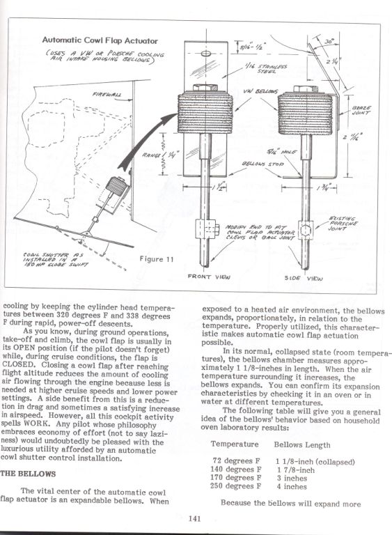

Bill Schlatterer
Posts: 195
PostPosted: Mon Jul 02, 2007 3:38 pm    Post subject: Automatic upper cowl flap Reply with quote
> "Get you a temperature bellows off of a VW engine. Sorry I don't know
the proper name. It expands when it gets hot, which it shouldn't do while
you're flying due to the airflow. But it will during post-flight taxi if
you rig it so that the expansion opens the hinged door that Charlie
suggests. Once the engine cools, it will contract to close the door again.
For a full description of the suggestion above, see pages 140, 141, 142, and
143 of Tony Bingelis book,...Firewall Forward. There are complete line
drawings, temp and bellows extension lengths, linkage design, etc. Very
informative and very simple,... almost elegant Smile
Bill S
7a Ark - not yet flying Sad
Bill Schlatterer
Posts: 195
PostPosted: Mon Jul 02, 2007 4:10 pm    Post subject: Automatic upper cowl flap Reply with quote
OK, here is a teaser. This is one of the Bengilis pages (P141) showing one
of the cowl flap actuator bellows.
Bill S

lm4(at)juno.com
PostPosted: Tue Jul 03, 2007 6:13 am    Post subject: Automatic upper cowl flap Reply with quote
Carlos,
I've found it.
Firewall forward by Tony--Page 141 shows the "VW or Porsche air intake
housing bellows" and measurments. Page 142 shows a picture of how it is
hooked up. It even has an manual over-ride and a flap position indicator.
Larry Mac Donald

PostPosted: Tue Jul 03, 2007 11:17 am    Post subject: Automatic upper cowl flap Reply with quote
Thanks Larry
Another fellow lister ( Bill S ) already sent me a scan of those pages from
Tony Bingelis' book.
Thanks to everybody who responded.
Carlos
