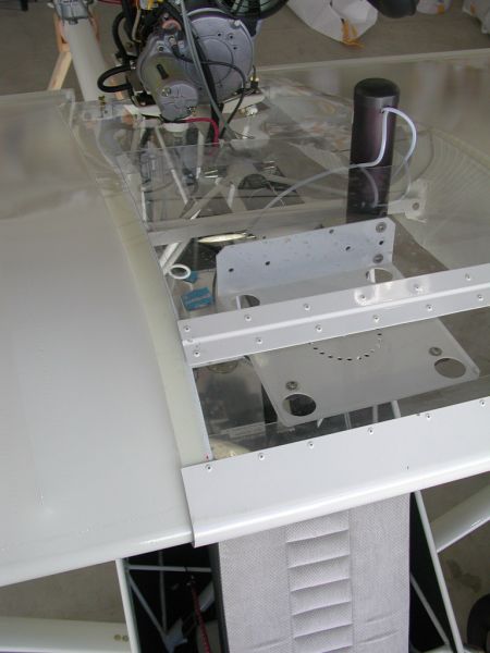

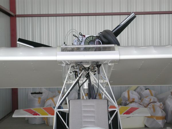

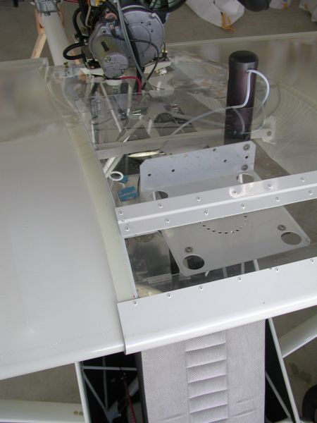

PostPosted: Mon Sep 17, 2007 7:15 pm    Post subject: Re: Gap Seal Reply with quote
John H says: "Some low time Kolb pilots don't know the difference between a good flying
Kolb and one that flies like a dog. "
...... I know how mine flies, but I do not have anything to compare it to; I may be flying a "dog".
I am a low time Kolb pilot and I only have my Kolb to judge flight characteristics from.
I built a Gap Seal from lexan. The top is nearly a complete seal except for the area around the the engine mount. There is no TOP side coverage on a section about the size of the engine mounting plate platform.
I have a BRS on a shelf under the seal and I fabricated a door that will allow the chute to pass through if ever needed. It is held in place with a aluminum hinge and Velcro. I have been experimenting with the amount of Velcro needed to keep it closed during flight, but not enough to slow the chute deployment. It has partially opened in a corner during flight, I am looking at alternate ways to hold it in place.
The bottom is OPEN. The leading edge is formed aluminum and that extends about 12" back, but then it is open all the way to the rear.
My question is about the open bottom. I saw it quite a challenge to build the bottom section around the BRS, and it got harder the further back I went. I figured the the top was the most important and I could skip the bottom.
Does an open bottom gap seal = a "dog" Kolb?
The pictures are some I made when I was fitting up everything. The BRS pack is missing plus I had not finished the Velcro around the trap door.
What do you think Kolb fliers?

PostPosted: Tue Sep 18, 2007 11:06 am    Post subject: Gap Seal Reply with quote
The bottom on mine is open and just slides into the tracks on the end of
the wings, held by two screws on the front. Flys fine.
It's not as wide as a Mark III gap seal would be, so I don't know about those.

PostPosted: Tue Sep 18, 2007 7:51 pm    Post subject: Gap Seal Reply with quote
What's odd is the number of people who say it makes no difference at all?
Anyway, I figure it's worth putting it on... once I get familiar with the
plane I might try it without it to see the difference.
I find it odd that people say that it makes no difference as well. I have
flown Mark III with gap seal ( mine) and another when I was getting my
Ultralight pilots lic with no gap seal and the one with no seal flew like a
dog. It was a bear to land, stall was about 60 or more with flaps. I
attempted to try to convince the guy to put one on. He would not. I believe
it is scrap parts now.
Larry C

PostPosted: Thu Sep 20, 2007 6:39 am    Post subject: gap seal Reply with quote
Dana
Or you could make it permanent, bolt it on and forget it.
Boyd
My thought is to use .040" clear vinyl sheet, velcroed to the wings and
wrapping all the way around, and secured with cords where it breaks for the
cage structure. Quick and easy, and since it wraps all the way around and
attaches to itself, no chance of it coming off and going through the
prop. Comments?
-Dana
