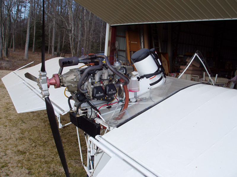

Hey gang,
I seldom look at barnstormers but did today and noticed this photo of a prop hub extention. It is the same type I bought 3 of before learning that it's not the one of choice. It is tapered and uses the 1/2" bolts into the gearbox flange. and has no lugs on the prop side. After many phone calls and my good friend at TNK sending me the latest hub extentions they are selling, we wound up making our own. It uses the 912 lugs on the gearbox flange and the prop side and the 8mm bolts. I also learned that the tapered extention was used on earlier 2 cycle engines and 2 blade props. I have one of those if anyone needs one. The extention that TNK is sending out as of late is good with one exception. on the prop side the 912 lugs fit lose in the holes. Meaning that you would have to hold the back of the lug with vice grips or pliers. We made ours so it is the same press fit as the prop flange on the engine. Worked out real nice. We can offer the aboved extention if anyone wants one for $300.00 labor is 200.00 for machine work material is about 40 bucks.
Is anyone running one of these tapered hubs without the lugs and have the warp hub mounted backwards useing the smaller bolt circle? If so do you think it is safe? Darryl at warp said he would rather not see the 68"+ 3 blade used in this configueration .
for what is worth.....

Paul Petty
Joined: 11 Jan 2006 Posts: 226 Location: Mississippi
Posted: Fri Feb 23, 2007 4:56 pm Post subject: Re: prop hub extentions |
here is the hub in question

Paul Petty
Posted: Fri Feb 23, 2007 5:24 pm Post subject: Re: prop hub extentions |
here is the one i found on barn stormers

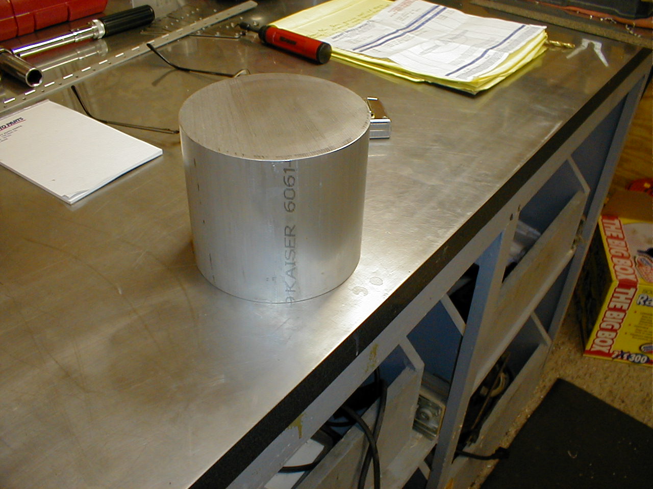

planecrazzzy Guest
Posted: Sun Feb 25, 2007 7:18 am Post subject: Re: prop hub extentions |
Hey Paul,
What grade of aluminum was used ? 7075 ?

Paul Petty
Posted: Sun Feb 25, 2007 7:30 am Post subject: Re: prop hub extentions |
Mike,
I used 6061. Here is a before shot.

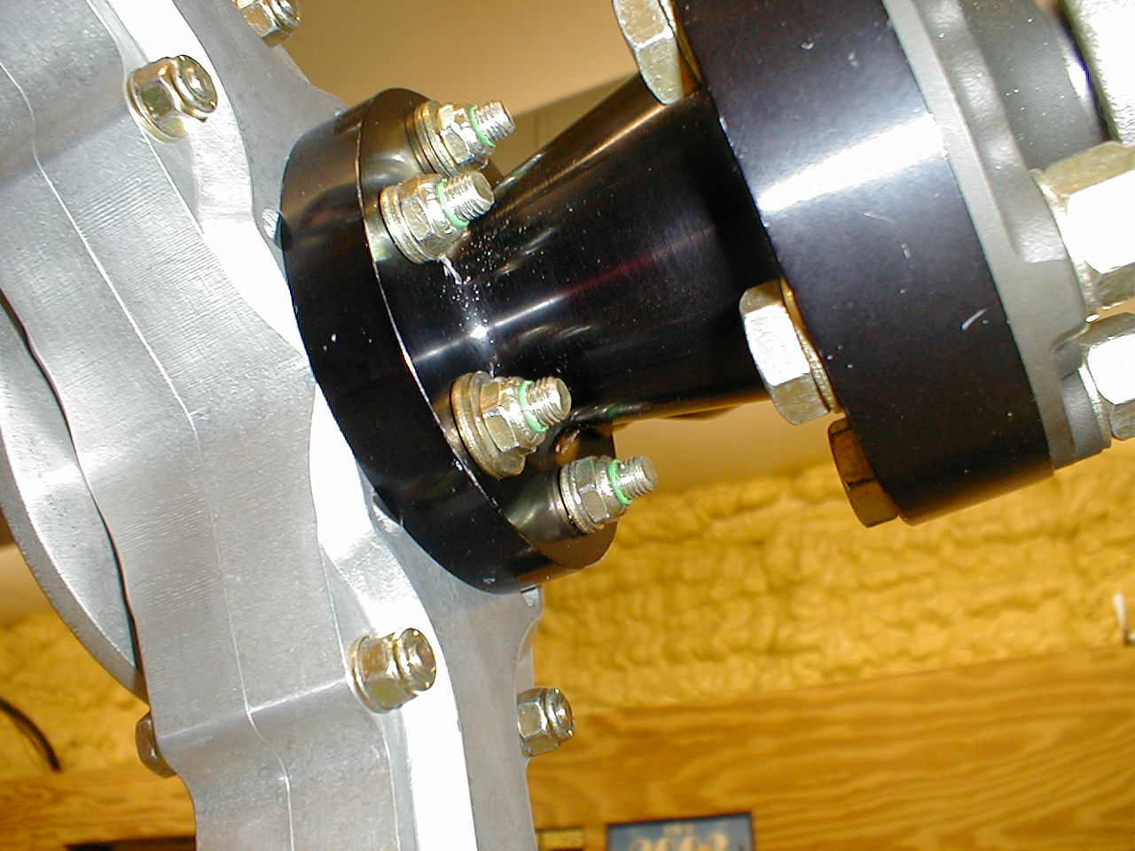

JetPilot
Joined: 10 Jan 2006 Posts: 1246
Posted: Tue Mar 06, 2007 5:07 pm Post subject: Re: prop hub extentions |
I had some of the same questions about my Prop Extension on my 912-s. I am not concerned about having lugs or not where it bolts down to the 912's, those bolts are huge, and the diameter of the pattern is large, meaning the will be lightly stressed. I have one of the RED extensions you posted in some of your pictures. I have two concerns about this, first is the taper in the extension itself down to 2 inches before the flange to attach it to the prop. Second, using the smaller bolt pattern on the warp puts a LOT more stress on the small bolts that attach the prop to the spacer itself, these bolts are pretty small and do break sometimes. The stress on those bolts increases almost exponentially as the bolt pattern diameter gets smaller. Its just plain dumb using the smaller pattern when the larger one could be used. Attached is a picture of my spacer...
I like two things about your hub, first is has no super thin taper in it sressing the aluminum neck itself. Second is the larger bolt pattern on the prop side takes a lot of load off the thin prop bolts. ( I also like the cool black color it matches my prop ). One thing I have to ask though is why use 6061 aluminum instead of 7075 ? Isnt 7075 a lot stronger ? If memory serves me right, isnt the red spacer made out of 7075 ?
Posted: Fri Mar 09, 2007 11:47 am Post subject: Re: prop hub extentions |
Hi Paul,
What do you mean by sandwiched ? I am including another picture so you can get a better look at it, if you see something that does not look right please let me know !
I used cotter pins because they are easy, and I had the cotter pins. Is there a reason not to use them on the extension ? The Kiev prop is VERY light, and uses the smaller bolt pattern only. It performs well, is smooth, and quiet, but the hub and blades are so light that is scares me. It would probably be fine for a smaller 2 stroke engine, but it does not seem strong enough for a 912-s. The other problem is that if something came off the engine and went into the prop, the Kiev would surely explode into a million peices
I have a Warp drive prop with the larger bolt pattern sitting in the box just waiting to bolted on After seeing how light the Kiev prop is, the small bolt pattern, and the small neck in the spacer, im just not willing to be the test case for this setup....
Mike

Paul Petty
Posted: Sat Mar 10, 2007 10:50 am Post subject: Re: prop hub extentions |
Mike,
Look at the side view of your prop hub. Notice how the 2 "Halfs" dont completely touch at the top but almost touch at the bottom. The warp is completely closed when torqued to spec. Yours might be fine. Just a thought.

JetPilot
Posted: Sat Mar 10, 2007 3:12 pm Post subject: Re: prop hub extentions |
Hi Paul,
The torque on the prop bolts is 14.5 foot-lb, for both the 6 that holds the prop to the spacer, and also 14.5 foot-lb for the bolts that clamp the blades down ( 2 each for a total of 6 ). I used a very accurate torque wrench and was very careful to get the torque perfect on each bolt. I also used the sequential pattern to attach the prop to the spacer. The picture you see is a fully tightened and adjusted prop... I never really paid attention, but looking at the picture I have no idea why the space varies a bit between the hub halves. The 2 halves never touch together anywhere, there is a space along the enitre hub.
Do most people use Nylock on the prop bolts ? It would have certianly been easier and I would like to change them if that is the way to go. I had to file washers, or add them to get the correct torque so that the cotter pin grooves lined up with the holes. It was a pain in the arse !!!
Every time I look at your spacer, I like it more Nice, thick, strong, and a cool black color that matches my prop.
Posted: Sat Mar 10, 2007 3:19 pm Post subject: Re: prop hub extentions |
Looking agian, yours is silver, but it could be anadozied. I do like the thick neck of yours. The taper to a very thin 2 inches on my spacer and the black spacer you have in your pictures one scares me on the Kiev Prop, I really would not trust it on the much heavier warp drive prop.
