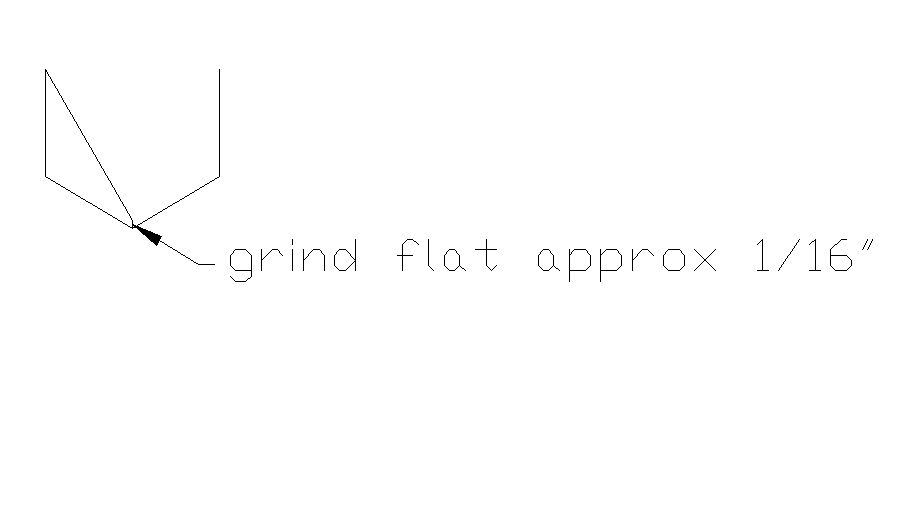

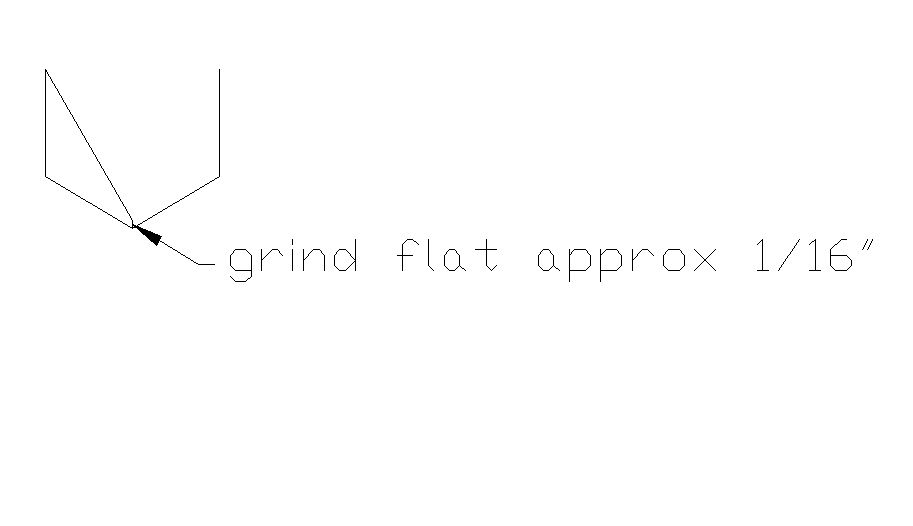

Boatner, Just in case, cut your Lexan with an abrasive wheel, not a saw. I like the diamond wheels offered by Harbor Freight. When they're on sale, and that price recently doubled, they're still half the price of the large Dremel abrasive wheels and seem to last much longer.
While you can get special drills for plastic from ACS, you can make your own by grinding a small flat on the chisel edge of the drill bit. If you try to use a regular bit, it will most likely get sucked into the material and cause a crack. I've attached a drawing that explains, I hope.
Rick

I have a die grinder... is that what you are talking about using to cut Lexan? This will be the first time I've ever handled Lexan. I also have a Dremel.
Are you saying to slightly grind the sharp point of a drill bit to drill holes for attachment? Any advice you have to help me keep from buying several sheets is appreciated!!!!
Boatner

Boatner, I use a Dremel, but a die grinder should work just fine, too. I like the smaller diameter cut off wheels, they make a nicer inside radius than bigger wheels do.
As for the drills, the idea is to grind a small flat to make the drill scrape away the material rather than cut it away. This is a standard prep for drilling any soft material like plastic, brass or lead. It takes just a second to do with a bench grinder, but you could do it with a Dremel, too. All you need is a small flat to keep the drill from being sucked into the material without actually cutting which will cause a star crack every time.
Rick

If you are using .0625 lexan, it cuts just fine with a set of
straight jaw tin shears.. the bigger the better.. I use a std bench
grinder to taper and deburr.. Works for me... Herb

All I've ever used to cut lexan is a pair of tin snips, then smooth the
edges with a small Stanley Sur-form plane. The small curved one works very
well. Set it up to cut on the pull stroke. Lexan is very tough and very
different from plexiglass, which will crack at a hard look.
For a drill bit, if you have the knowledge and skill, grind your
own..........I bought a special bit from Aircraft Spruce, but I'd imagine
the local Ace Hardware and Aircraft Supply would either have one, or could
order one for you. Lar.
Lar.
Larry:
I also have always cut Lexan with aviation sheet metal snips, and hand
sand the edges nice and smooth as I can, before I get tired and go do
something else.
Unlike a lot of you all, I us "normal" HS drill bits, 1/8" for 1/8"
pop rivets, and 3/16" for No 10 screws.
All the above works well for me, but am willing to try anything that
will make the job easier and produce better quality work.
