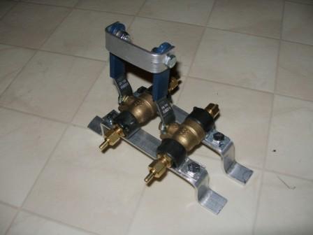

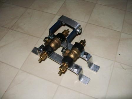

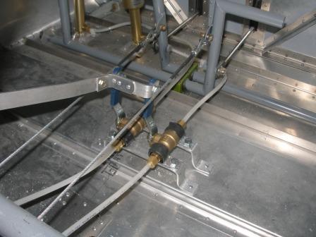

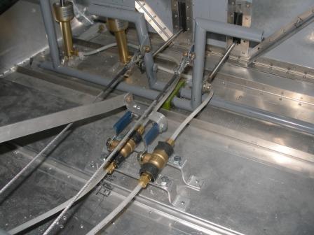

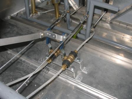

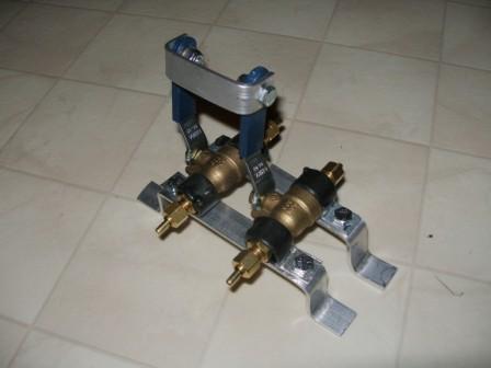

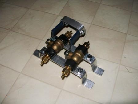

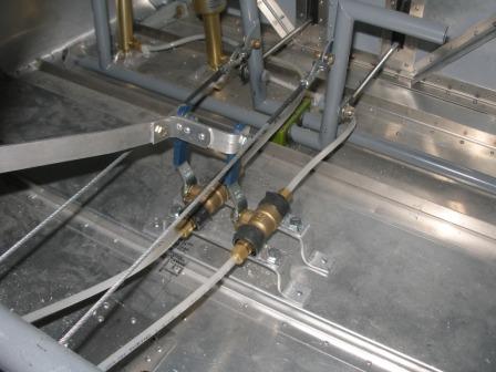

Listers, I went down to Home Depot and bought two small brass ball valves, made mounting brackets, a tie between the control levers and an actuator rod, all for about $35. Photos available for those interested.
Jay in Dallas
Jaybannist(at)cs.com

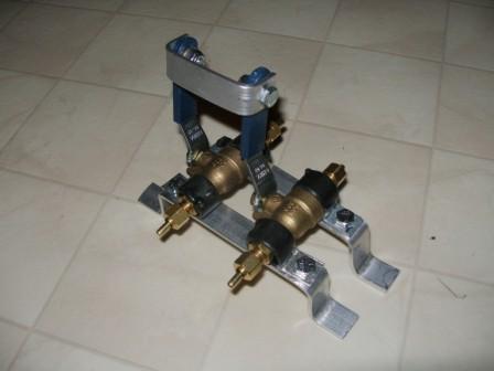

PostPosted: Thu Feb 22, 2007 11:26 am    Post subject: Parking Brake Reply with quote
List,
Here is my version of a homemade parking brake. Two ball valves from Home Depot, four Adel clamps and some 1/8" aluminum. I bolted the 1/8" bars together because I was afraid that A5 rivets weren't long enough.
With the levers down, the valves are open. Levers up they are closed and pressure is trapped in the lines from the valves to the brake calipers.
I used a bar for a control rod because I couldn't figure out how to make a cable work with the large arc of the levers.
Jay in Dallas
