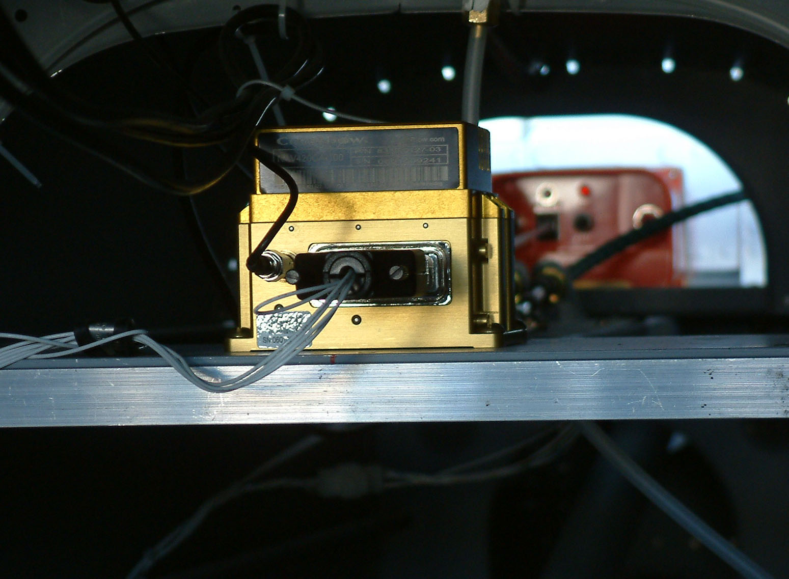

Last October I sat in a conference room at Crossbow and went over each problem they resolved. All of the problems were of the maturing variety and none pertained to core technical changes. I was quite puzzled by D2A "toss everything out" reactions.
I met with Crossbow face-to-face and came away comfortable with their answers and their product and choose Crossbow for my WTD Aviation Technology primary flight display product. Two of these units have been installed to date and both work flawlessly.
During 3 years of investigating and installing gyros it was apparent that the numbers you get from the gyro depends greatly on the installation. See the attached photos (yes- we turned the XBow around). By far the best location for the Crossbow is on a reinforced (stiffened) plate attached to the longerons using the same holes where the aft end of the rear shoulder harness cable connects to the longerons. In fact, the shoulder harness cable end was relocated to the plate. This location allows the gyro to be perfectly aligned with the aircraft axis and is magnetically minimized from the pitch servo and the trim servo. Don't let the small size of the trim servo fool you - it casts a magnetic field 20 inches from the unit. Note that the gyro was attached with brass screws.
Looking over the possible locations for the gyro GPS antenna its obvious that the best probable location is the forward tip of the vertical stablizer and an easy location is just under the fiberglass fuselage to vertical stab fairing. Out of curiousity, I took the easy route and it has worked without fail. The antenna was aligned with the vertical stab to minimize the RF shadow. A status on my PFD shows when the gyro has locked the GPS constellation and it locks about one minute after I start my taxi from the hanger. Once locked on it has never dropped. If it starts dropping out then I will relocate the antenna to the vertical stab forward tip.
The Crossbow gyro has the capability to calibrate its compass for hard iron interferrence. From my previous experience with gyros it was obvious that the Crossbow is very sensitive, so I included the commands necessary to begin and end this procedure into my PFD product. It is a quick and simple procedure that will maximize the accuracy.

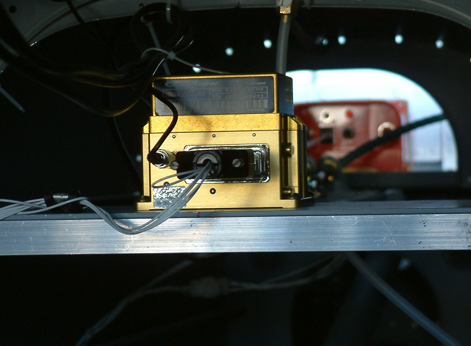

PostPosted: Mon Feb 19, 2007 4:07 pm    Post subject: Crossbow vs Pinpoint Reply with quote
John-
Its impossible to locate the gyro at the CG of all axis [fuel & people variances?] so the consideration that I use is what is the best location that the unit will provide excellent information. "Perfectly aligned" as I used the phrase is meant to be parallel with each axis. It may be offset from the origin but should not so far to affect the numbers in a meaningful way.
So, I recommended the aft gyro location based upon the following criteria and in the following priority:
1. Location that can be "aligned" (parallel) to all three axis as close as possible.
2. Minimum offset from roll axis (Roll axis moves fastest and distance from this
origin will create large errors. IE: not out on wing)
3. Area where the magnetism is constant (not near baggage area)
4. Minimum surrounding magnetic fields
5. No strobe, battery, nor navigation wires
The value of setting the plate on the longerons is an immediate 2 axis alignment - pitch and roll. By running a string through the length of the cabin yaw orientation can be easily determined. All internal Xbow sensors are aligned physically and by calibration to the mounting holes. A much more difficult mounting would be some inches lower that would align with origin of the roll axis. However, the gain is small compared to the effort - and it now allows the other two axis to vary.

there are no companies with "strong ties" to D2A, because
Chelton itself is distributing the pinpoint, and they are also
involved in suing D2A....so there are no warm fuzzies even
by them for the people at D2A. Products are products, and
should be judged on their product quality. Politics aren't
really things that enhance the ability to choose the right
product. There were lots of bad things happening by multiple
parties a year ago. At present, I think the real bad eggs
are now expunged and what's left is the same products being
offered, but from a more reliable source. And Crossbow has
really whipped themselves into a good playing team too...so
you really can't go too awful wrong today.
What you really should do is dig in though on the Chelton
EFIS forum at http://www.CheltonEFISpilots.com, because there
you should be able to ask these questions and get responses
from a much higher number of people who can respond with
actual in-flight experience with either. With either
system, make sure you do a real "by the book" install
and you'll likely have success. The pinpoint just makes
the job easier by it's design. Hopefully we'll eventually
see a similar unit available by another manufacturer like
Crossbow, as the design itself is much easier to work with.
For the small price difference today though, I myself
would choose the pinpoint if I was [quote][b]

I just wanted to poke my head in here and provide a couple of pieces of information for those that are considering mounting a NAV425EX in their aircraft.
1) You do NOT have to mount the unit at the CG of the aircraft as has already been stated in this forum. We recommend in our installation manual that our customers mount the unit as close as possible to the CG, however given the size and nature of RV's/Lancairs a better location is aft of the baggage area. The intent of mounting at the CG is to prevent any "lever affect", however this really doesn't occur in such small aircraft.
2) Please note that we are currently recommending an external mount GPS antenna (TSO'd) be used with all installations. I understand that this causes some heartache for builders, however please note that there isn't one certified GPS antenna made for internal installations. We believe and our testing has proven that there is a reason for this. In theory composite aircraft should be transparent, however our experiences have shown this to not hold completely true. We urge all of our customers to consider the Antcom 2G15A-XS-1 antenna or a suitable alternative called out in our service bulletin.
Sincerely,
