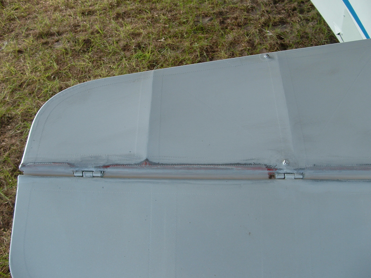

PostPosted: Wed Mar 28, 2007 9:12 pm    Post subject: Gap seals Reply with quote
Hi Kirk,I made my own gap seals on my kitfox 4 and they work great,after
talking with the group I decided to do mine with 3" wide pinking tape and
repaint my fabric on the tail,just a little poly tac and some pinking
fabric and it makes a nice looking pro job.....heres a pic.....
hopes it helps you out....MarkN61AC
