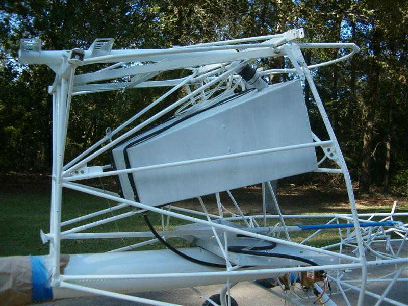

PostPosted: Wed Feb 14, 2007 5:00 am    Post subject: Re: Gas Tank Study Reply with quote

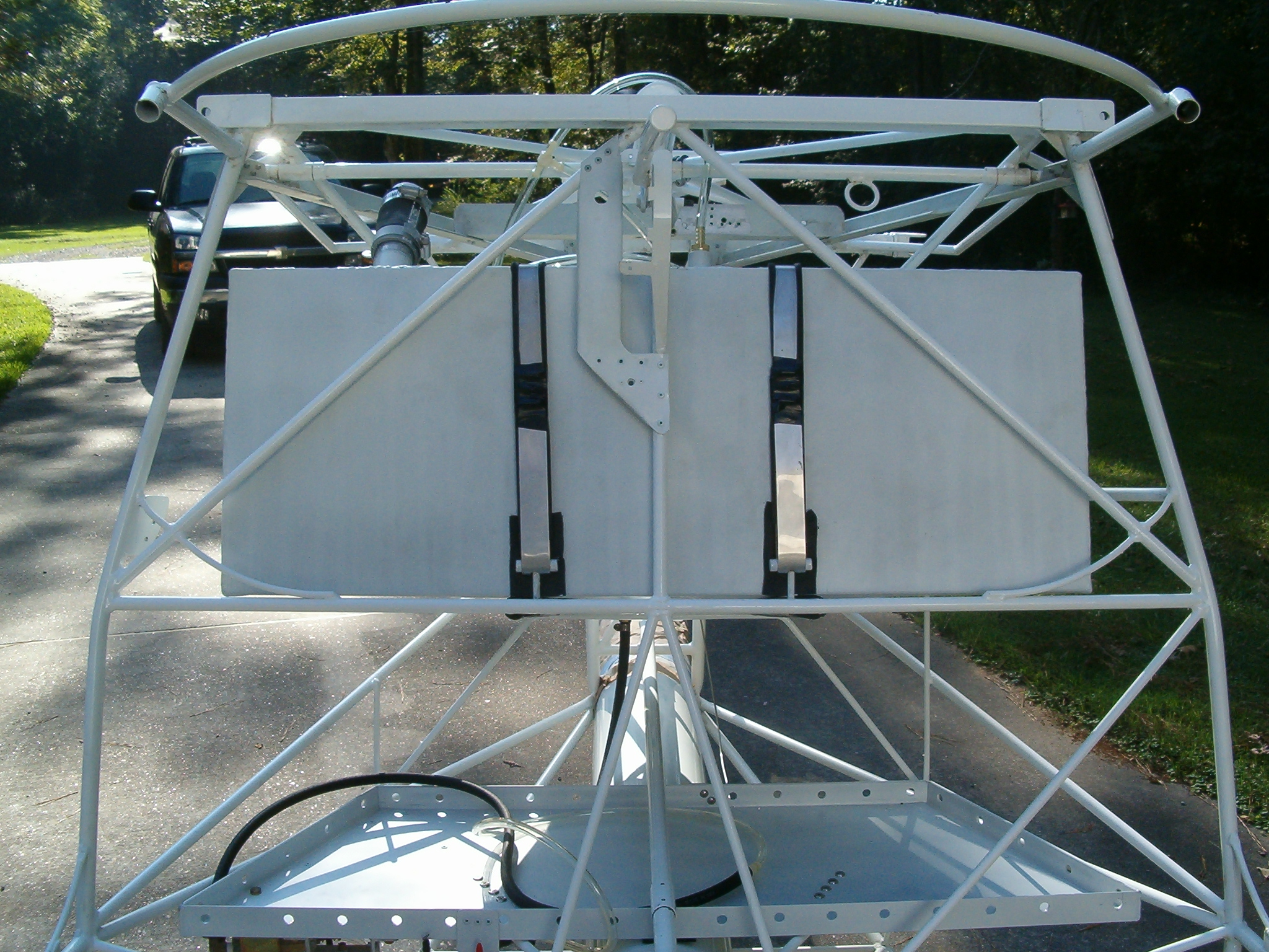

Just some pitures from my recent efforts. It is basically the Brothers Hauck design. A little thicker (.063"). Originally calculated 20.5 gallon capacity. Ended up 21.5 gallons when I did the flow test and level gauge markings check.
Still haven't flight tested it yet!

Thanks too much,
John Bickham

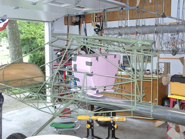

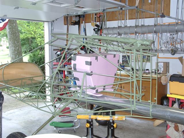

PostPosted: Wed Feb 14, 2007 10:15 am    Post subject: Re: Gas Tank Study Reply with quote

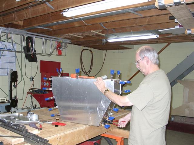

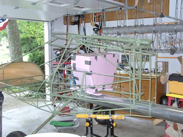

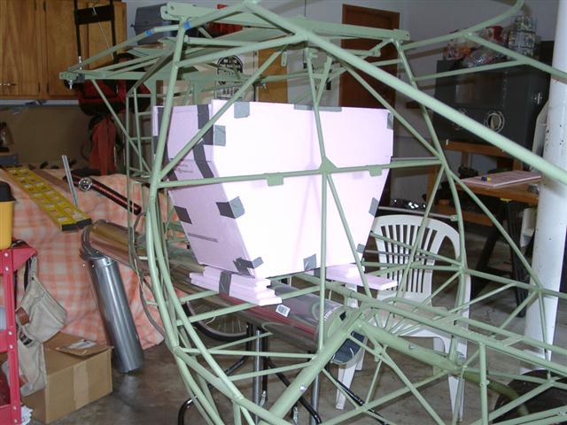

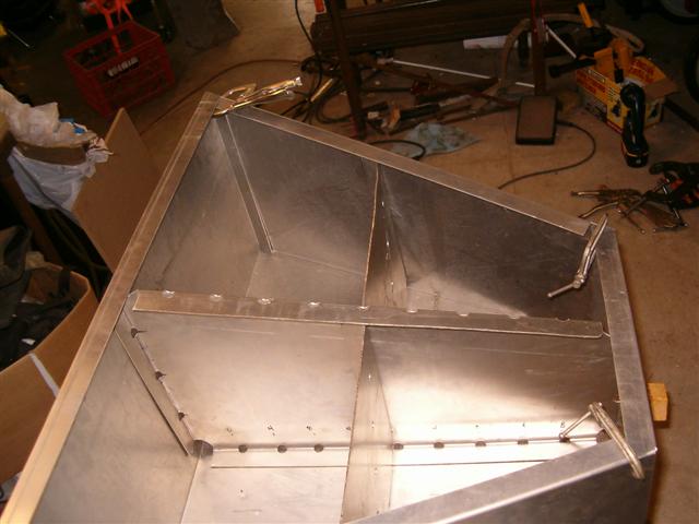

Here are some pictures of my gas tank mock up and fabrication. the shape allows it to be installed with just one cage tube cut out. The sloped sides allow for room to install the fuel pump, gascolator, hot box and battery. It's about 19 1/2 gallons. I added an extra fitting on top so I could pump fuel into it from an aux. tank in the passenger seat if ever required. I had to fabricate and weld in a mounting platform for it to sit on.
Rex Rodebush

PostPosted: Wed Feb 14, 2007 6:06 pm    Post subject: Gas Tank Study Reply with quote
Rex:
My fuel tank is very much the same shape as yours. We designed mine
to fit in the upper rear half of the fuselage in order to open up the
bottom rear for a cargo compartment. Looks like you could do the same
thing and not kill available cargo space.
With 25.0 gal I never consider using the left seat for an aux tank.
That is my flight desk. Wink

PostPosted: Thu Feb 15, 2007 8:30 am    Post subject: Re: Gas Tank Study Reply with quote
Hi John,
I thought about mounting the tank as you did but was concerned about aft C.G. (I know this has been talked about before and your tank has not been a problem for you!). Anyway, while the area under the tank will have the battery, hot box, fuel pump, gascolator and ELT; I will make a storage area behind the tank, accessable from the outside, for lighter stuff. ie, sleeping bag, tent, etc.
Rex

Rex:
Neither has the 11.6 lb Maule Tundra Pneumatic Tailwheel and 125+ lbs
of gear under the 150 lbs of fuel.
Your system will work fine, but will be limited on amount of gear you
will be able to carry.
John Bickham

PostPosted: Thu Feb 15, 2007 9:52 am    Post subject: Re: Gas Tank Study Reply with quote
Rex Rodebush Posted: Thu Feb 15, 2007 10:30 am Post subject: Re: Gas Tank Study
Hi John,

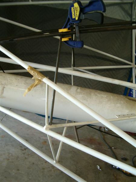

I too was concerned with aft CG. I'm not an engineer, but here was my feeble attempt to distribute the load of the tank more forward. I added a small brace that connected to the tubing that supported the original tank.
Just another way of doing it. I think is will help some. Either way, it stiffens everything up.

Rex,
Did you add some fuselage to the rear of your airplane? If so why? Looks good!
Paul Petty
Kolbra #12
Ms Dixie
912 UL 70" warp
Rex Rodebush
Posts: 209
Location: Branson West area, Missouri
PostPosted: Thu Feb 15, 2007 1:46 pm    Post subject: Re: Gas Tank Study Reply with quote
Rex,
Did you add some fuselage to the rear of your airplane? If so why? Looks good........
Paul,
No, the cage is as received from Kolb. It was one of the first X-tra cages. I think the present ones are a little different in the back.
Rex
