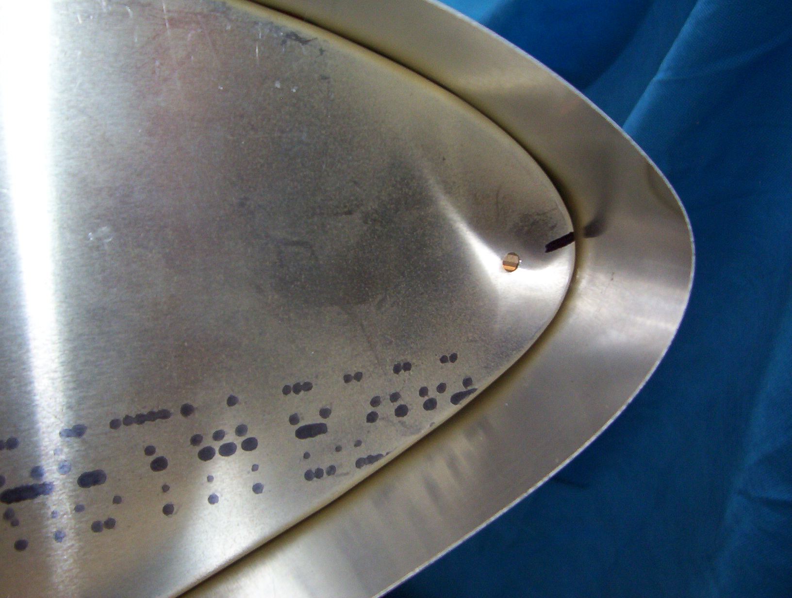

Well after spending the last week or so on the LE skin I have to admit, I MADE A MISTAKE!.
The skin radius was to small using the 1.75 stop blocks and I will try again tonight. This time I will make several test strips and work it through the whole process. Also I will start with 58mm blocks, just like it says on http://ch601.org/resources/Nose%20Skin/bending_a_nose_skin.htm More later.

Only needed to make one test strip the directions on CH601.org work great.
How's that for a fit?
