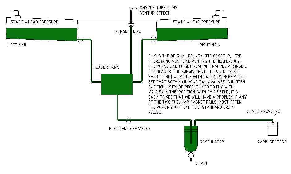

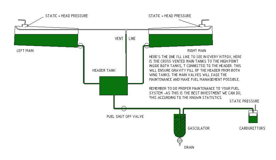

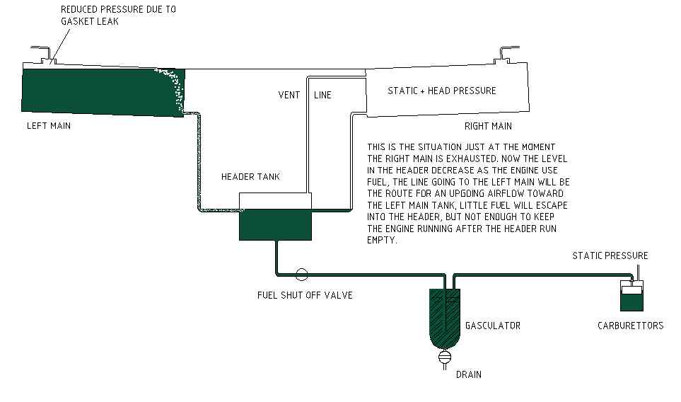

Hi Folks,
I've just finished two new sketches of the "failure modes", then the old
"original" Denney setup and the cross vented main tank setup as I'll like
to see it.
The first drawing show a leaky gasket in the right tank, in this situation
we'll be able to use fuel from the right tank until empty. The next
drawings has some explanation text included in the drawing itself.
This first drawing show the situation with a leaky right hand fuel cap
gasket, the second drawing is same situation -with left side this time,
the third drawing is the original Denney fuel system setup as far as I'll
know, and finally the fuel system of to day but –cross vented as I'll like
it to be.
Now folks, remember this failure modes can be tested safely on ground for
everyone to see... You could also test the benefit of a cross vented
system..
There is one thing to be said in general, if your system is kept in good
condition (maintenance well) both system will serve you fine. However, if
things "worn" over time -no one can assure for correct function..
Next time I'll like to address some other items in the fuel system.
(PS. Will be travelling for some days.)
Torgeir.

Torgeir,
I think I see a problem with your figure (fuel_4). My water manometer shows
a column of water 4.5" tall will create the pressure at the pitot tube to
register 100 mph. which is a bit more than the avarage Kitfox will fly
(sorry to the 5 through 8 guys, but average is average and you guys will
come in later). A rough estimate gives a column of fuel at say 6 inches at
that speed. Conversely an airplane flying at 100 mph will has the ability
to lift a column of fuel about 6 inches. What that indicates to me - if
the header tank is full and the left tank is full as you show, there will be
fuel to some level in both the fuel line and the vent line on the right side
due to head pressure from the full tank. The level will be somethiing like
6: below the tank fuel level. As I measure it I have about 10 inches from
the level of the fuel tank outlet to the header tank inlet. There is
insufficient pressure generated from the "pitot tube" type air vent on the
non leaking tank to force a breach into the header tank as long is there is
at least some fuel in the (leaking gasket) tank and the airspeed is no
higher than, say 115 mph. Air at .04 psi won't lift a column of fuel 10
inches.
Further all aircraft sold after about 1994 - the aircraft capable of higher
speeds have the header tanks low behind the seats with a pressure head of
more like 18 to 20 inches. With these airplanes the .04 psi from the intact
fuel cap won't force air in the fuel line or vent line more than about
11inches below the fuel level in the system even at VNE. I doubt there is
any way to introduce air into the full tank to header tank feed line in our
airplanes in the scenario you illustrate.
Also the diagram of the header tank reflects the round header tank of
several models ago consistent with the diagram of (Fuel_5) The newer
header tank has the inlets from both tanks on the top surface as well as the
vent line. Provision is made for a quick drain on the bottom and fuel
outlet about an inch or two above that on the forward facing side.
Lowell

Torgeir:
On the second diagram you showed the left tank dribbling fuel into the
header tank. I expect that you won't get a pressurized head of air over
the fuel in the tank but neither will you get a vacuum to hold the fuel up
in the tank. Let alone suck air from the empty tank. Even though the cap
isn't properly fitted the pitot effect should be enough to brake the low
pressure ( hardly a vacuum) on the top of the wing.
Why bother connecting a vent from the header to the cross vent in the last
diagram? Once you have the cross vent tube installed the air pressure on
top of the fuel should be consistent across both wing tanks regardless of
whether or not one cap is not properly installed.. The header will self
purge because you don't fill both tanks at exactly the same speed to trap
air in the header.... That is assuming of course you ran or drained the
header dry. One other thing... On my plane the inlets to the header tank
are "almost" at the very top of the header tank.... The vent comes off the
same level as the inlets.
Nice diagrams. I do like the idea of the cross vent. Then again I like the
idea of controlling the fuel flow too.
Noel

At 03:52 PM 1/31/2007, you wrote:
| Quote: | The first drawing show a leaky gasket in the right tank, in this situation
I agree with Lowell. My calc's, (already posted,) show you can't push
air down to the header tank using dynamic pressure from the pitot
vent. Therefore, though you can empty one tank, you can't drive air
into the header and out the other tank, precluding its feed. You
should therefore have about a 9" difference in fuel levels right to
left until the lower level hits the header tank. On my aircraft that
means you get to use one tank of fuel, right or left, since my header
sits low behind the seat.
Guy Buchanan
_________________ Guy Buchanan
Deceased K-IV 1200
A glider pilot too. |

alnanarthur(at)sbcglobal. Guest
Posted: Thu Feb 01, 2007 8:29 am Post subject: Fuel flow, summary so far. |
Torgeir etal.
Add a second airspeed indicator to your panel. Connect it's input to
the crossover header vent / crossover tube (drawing 4) between tanks.
If during flight, the second ASI shows zero or negative airspeed,
land and check your gas caps.
Al Arthur

Guy Buchanan
Joined: 16 Jul 2006 Posts: 1204 Location: Ramona, CA
Posted: Thu Feb 01, 2007 8:40 am Post subject: Fuel flow, summary so far. |
At 03:25 AM 2/1/2007, you wrote:
| Quote: | When you say "you get to use one tank of fuel, right or left", do you
mean that once that tank of fuel is gone you will run out?
When you have a cracked cap, (not the cap off,) and the high pressure
tank pushes the fuel out the cracked cap, it will continue to do so
until there is about a 9" disparity between the tank levels. At that
point both levels will drop together until the lower level gets to
the header tank whereupon vapor will transfer through the header
tank, possibly preventing additional flow from the higher level tank.
If your header is more than 9" below the tanks, you will then get
about all of the fuel from the higher level tank.
Guy Buchanan
Deceased K-IV 1200

Float Flyr
Joined: 19 Jul 2006 Posts: 2704 Location: Campbellton, Newfoundland
Posted: Thu Feb 01, 2007 7:57 pm Post subject: Fuel flow, summary so far. |
Not with a cross feed vent. Another good reason to install one.
Noel
[quote] --
_________________ Noel Loveys
Kitfox III-A
Aerocet 1100 Floats |
| Back to top |
Float Flyr
Posted: Thu Feb 01, 2007 8:00 pm Post subject: Fuel flow, summary so far. |
Cheaper to check the caps before flying.... Especially with the cost of gas
or whatever else they, oil and government, feist off on us.

Hi Lowell,
this is a good and correct observation.
However, you'll know I've never mentioned the height.
Sure, I've been informed that the new tank is located behind the seat all
the way down to the floor.
And you're right, the feeder tank I'm describing is the pre. 94 model
tank, "high" located behind the seat.
Let's do some calculations:
Now; 10.58 millibar (or 0.1534499 PSI) is equal to 92 mph or ~80 Kts.
Another important thing is the influence the low pressure might have here,
my finding is based on a standard profile at 5 deg AOA gave approx. 14.4
PSI with 92 Mph.
(This is a little conservative calculation, -but hopefully close to the
reality, at high angle the pressure can go down to ~14.2 PSI.)
Well, all of my assumptions is worst case, so anything less is better..
I.E. Delta P=((14.7-14.4)+0.153)PSI=0.453 PSI. This is the pressure that
will try to force the fuel downward the line until there is pressure
balance. The height between top of fuel surface inside left tank and the
level of the "downpressed" fuel.
Let's see what height this will be;
14.7 PSI represent 393.7" column of water (equal to 10 meter). The
following formula is valid for this calculation; 14.7
PSI/393.7"=0.453PSI/X
Then X=0.453PSI*393.7"/14.7PSI=12.123" column of water. Now, since fuel
(Mogas) is lighter than water we must recalculate as this:
Column of fuel = Column of water/spec. weight for
fuel=12.123"/0.71=17.088" (0.43 meter)
The height difference between the main tank output flange and the
carburetor inlet flange is 0.6 meter or 23.62". The old header in my
example is in between here, I.E. less than 0.6 meter.
Next thing is that the size of the feeder lines of this old setup
"originally" is 1/4" of diameter.
With the fuel demand from the engine, and this reduced flow the header
will decrease in level until the line unport and air start flowing.
Here's another one; the total length of all feeding fuel lines in my plane
is 5.13 meter equal to 16.6 feet!
And this one, let's say that the left only have say 5 Gallon and the pilot
make some left turns -airwork, observations who knows.
I've always search for the worst case just to clarify or.. justify..
Torgeir
On Thu, 01 Feb 2007 03:19:16 +0100, Lowell Fitt <lcfitt(at)sbcglobal.net>
wrote:
Torgeir,
shows a column of water 4.5" tall will create the pressure at the pitot
tube to register 100 mph. which is a bit more than the avarage Kitfox
will fly (sorry to the 5 through 8 guys, but average is average and you
guys will come in later). A rough estimate gives a column of fuel at
say 6 inches at that speed. Conversely an airplane flying at 100 mph
will has the ability to lift a column of fuel about 6 inches. What that
indicates to me - if the header tank is full and the left tank is full
as you show, there will be fuel to some level in both the fuel line and
the vent line on the right side due to head pressure from the full
tank. The level will be somethiing like 6: below the tank fuel level.
As I measure it I have about 10 inches from the level of the fuel tank
outlet to the header tank inlet. There is insufficient pressure
generated from the "pitot tube" type air vent on the non leaking tank to
force a breach into the header tank as long is there is at least some
fuel in the (leaking gasket) tank and the airspeed is no higher than,
say 115 mph. Air at .04 psi won't lift a column of fuel 10 inches.
higher speeds have the header tanks low behind the seats with a pressure
head of more like 18 to 20 inches. With these airplanes the .04 psi
from the intact fuel cap won't force air in the fuel line or vent line
more than about 11inches below the fuel level in the system even at
VNE. I doubt there is any way to introduce air into the full tank to
header tank feed line in our airplanes in the scenario you illustrate.
the vent line. Provision is made for a quick drain on the bottom and
fuel outlet about an inch or two above that on the forward facing side.
Lowell

Hi Noel,
I'll put the answer in beetween below.
| Quote: | On Thu, 01 Feb 2007 03:53:24 +0100, Noel Loveys <noelloveys(at)yahoo.ca>
wrote:
| Quote: | On the second diagram you showed the left tank dribbling fuel into the
up
See the mail just posted to Lowell.
| Quote: | Why bother connecting a vent from the header to the cross vent in the
last
the
As my tank has a colletion camber for air and vented at the top, it's a
must to be able to vent.
In your newer system,perhaps with 3/8" lines, the system will self vent.
| Quote: | Nice diagrams. I do like the idea of the cross vent. Then again I like
the
Torgeir.
Using Opera's revolutionary e-mail client: http://www.opera.com/mail/
