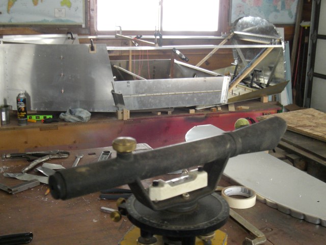

An excellent method for accurate leveling during fuselage construction.

I just use a Smart Level mounted in a 48" beam. Works very well. Also useful for matching blade pitch angles on a G.A. prop.
