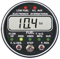

PostPosted: Wed Jan 31, 2007 12:09 pm    Post subject: Re Floscan Sensors Reply with quote
Paul,
There are several of us on this side of the water that have the Electronics
International FP5/5L fuel flowmeter. These models use a FT60/90/180 flow
sensors. I don't know whether EIs sensors are rebadged Flowscan ones or not
but they seem to operate on the same principle. The important thing is that
they are FAA approved with an STC and some 55 different types on the
Approved Model List. More importantly for British Europa builders the FP5L
is approved by the PFA.
I have operated with the FP5L in my 914 Europa for over 4 years and have to
say it is the 'bees knees'. It has proven to be very accurate and fault
free. I have the Airmaster CS prop and I tend to set the power for cruise
using the fuel flow. It will also give the fuel at your destination if you
interface the unit to the GPS. I have this facility - this also works a
treat.
For more information see http://www.buy-ei.com/index.htm
PS. I have no connection with EI, I just think the FP5L is excellent.
regards,
Mike (G-JULZ)
