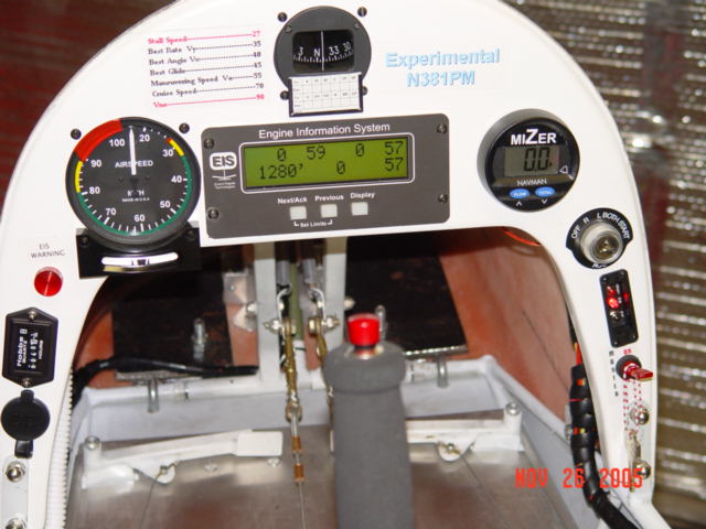

PostPosted: Thu Jan 25, 2007 4:00 pm    Post subject: Re: Airspeed Indicator Markings Reply with quote
Hi Mike,
I bought my arc's at ??? ACS&S or LEAF....
One thing to remember , If you look at the picture that I attached...
The Airworthiness Inspection requires the glass to be taped to the outer
ring.....Notice my Red Vne.....it overlaps.
Gotta Fly...
Mike & "Jaz" in MN

PostPosted: Thu Jan 25, 2007 5:35 pm    Post subject: Re: Airspeed Indicator Markings Reply with quote
Hi Mike,
That is the same ASI that I have ! Same ESI also. What is LEAF and also, where did you get the transparent decals with the lettering that give your V-Speeds and that says ESI warning ?
 Filesize:  168.45 KB
 Viewed:  515 Time(s)
Kolb MK-III Xtra, 912-S
planecrazzzy
PostPosted: Thu Jan 25, 2007 6:36 pm    Post subject: Re: Airspeed Indicator Markings Reply with quote
Hey Mike,
I'm a "Cheap" SOB....Those were typed on the computer, Then printed out....cut out....and "Taped"
( By the way , I changed those "V - Speeds" , I had some wrong )
That's another thing that they want for the Airworthiness inspection....
EVERYTHING LABELED....So until you get it the way you want it...
A quick solution is to type it , print it , Tape it...
Do you have the VSI in your EIS ? .....( I Love mine )
Well, it's Not LEAF...... it's L.E.A.F. I think there in Wiscosin....
I bought my Engine and prop from them...
Here's there address :
http://www.leadingedge-airfoils.com/
They have a catolog too , it's not as big as ACS&S
Gotta Fly...
Mike in MN
