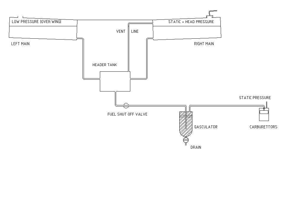

The Kitfox tank system with two wing tanks and one header tank, is using
both the head pressure and the gravity to ensure adequate fuel pressure
for our engine.
At first this might seem simple and easy, -but is it?
Let's have a look at the system as it is today; with two wing tanks, the
previous wing tank valves removed and the header vented to the right tank.
Now, can you see that the header tank is filled by the gravity only??
If everything is as it "should" be this system will work fine.
However, what will happen and how -if we forgot to install one of the tank
cap (let's assume the left) ?
OK., everyone know that our tank will start loosing fuel, but how? Well,
remember that our right tank is at "static pressure", in addition it is
pressurized "a little" by the head pressure entering through our "vent"
line installed in the fuel cap.
So here's a pressure difference of approx.: (0.2 - 0.3) psi air pressure
between each wing tank, the high pressure is in the right tank, therefore
fuel transfer from right to the left tank will take place.
You see, here the left tank will continue overfill until the right tank is
empty. After the right tank is exhausted, the level in the header will
decrease to the "height" position of the input line coming from left main
tank.
Now, we'll have a continuos airflow from right to the left main preventing
much fuel from the left tank to flow into the header, soon the header is
empty -and the engine stop.

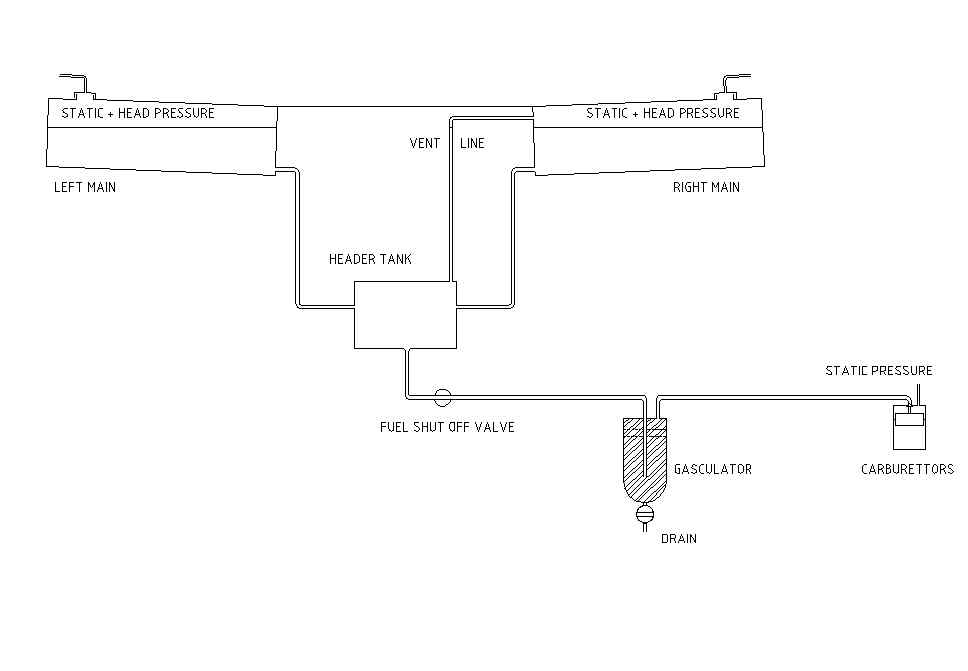

This next one drawing show the same system with a missing left fuel cap;
Next time (in a couple of days), we'll have a look at other and more
interesting failure modes in this same system, and later on the old
system...
Torgeir
Torgeir, your second drawing comes as a corrupted file on my computer.
Could you check and send it again, please?

Thanks for staying with this. It's important. It's pretty clear
from your example that we want a cross vent so the tank ullages are both at
the same pressure, the way Cessna does it. And in retrospect it would have
been easy to do, too. All you would have had to do was duplicate the tank
inboard vent on the other side, then run a tube straight across the back
spar from vent to vent. T off that for the header vent and presto, no fuel
transfer once the vent transfers vapor.

The drawing went through just fine, -but sometimes "Cyber Space" can
play..
I'll promptly send off list to you.
Torgeir.

Yes, it does, sometimes, Torgeir. I got it off-list and it's just fine,
thank you.
What I find interesting is that your drawing is a true copy of my fuel
supply system. It confirms again that the original builder of my plane
(not the one I bought it from) Harald Lien from Stranda (Molde
flyklubb) did a fantastic job at building it - by the book. Ever since
I have been on this list, reading all the good tips from builders, I
see that Harald knew them already in the period 1991-93, when he built
my plane. She is beautiful, what we call in Norwegian: en klenodium - a
jewel.

I'm not sure what you're asking, Torgier. I did some calcs and the dynamic
pressure at 115 MIAS at sea level equates to about 9" of static fuel head.
(Assume the static pressure is the same across the open cap and at the vent
pitot tip, a reasonable approximation.) This appears to mean that as long
as you're going fast you can empty the left tank. When the fuel level in
the left tank/line drops to 9" below that in the right tank you'll be at
equilibrium. This will leave nearly the entire left fuel line and vent line
full, and the right tank full. Both levels will drop simultaneously, all
things being equal, with the left level 9" below the right. (This assumes
the top of your header is more than 9" below the bottom of your tanks. I'm
pretty sure mine is.)
If you slow down the 9" static fuel head drops as the square of the
velocity. (E.g. at 57.5 MIAS the head will be 9/4" or 2.25") If you climb
the static fuel head drops linearly with the air density. So if you find
you're blowing fuel, slow down, climb high, lift the streaming wing a
little, and you should be fine. Indeed you should be able to lift the wing
enough to stop the leak.

My numbers are similar to Guy's
Some years ago I used a water manometer to check my airspeed indicator. It
doesn't take a lot of Delta Water to indicate our airspeeds, for esample
the delta at 30 mph is .74 inches, 90 is 4.13 inches and 6.18 inches at 120
mph. Since our fuel is about .75 the density of water, the head of our fuel
would be .98", 5.49" and 8.21" at the corresponding airspeeds.
I had often heard it said that the pressure from the pitot vents is about
one or so psi. Apparently this is not true as the pressure at 120 mph would
need to be about .3 psi to maintain a 8.21" column of water.
What this means, I haven't a clue really. This I do know, On a flight from
Las Vegas to Ely, Nevada a couple of years ago, I noticed the right tank had
lost most of it's fuel. The left tank was essentially full. On landing I
found that the fuel cap on the right tank had been attached at only one
side. For me, at least, I lost fuel apparently from a venturi effect and
the low pressure on top of the wing from the mis fit cap sucking the tank
dry and had apparently very little transfilling from the pressurized side.
Lowell

Lowell was it the left tank that had the cap partially open?
What I'm thinking is once the left tank is emptied a bit the vacuum caused
by the loose cap will travel along the vent line for the header tank to the
top of the right tank. Once the fuel in the right tank is below the level
of the vent the vacuum will be broken by air coming in the right forward
facing vent.
If the right cap was the one partially open, the vacuum would have been
ducted to the header tank by both the vent and the right gas line. That
could allow fuel to be drawn form the left tank faster than normal.
This is just a guess. When you get into fluid dynamics things get a little
strange a lot of fast.

That's a tough one to figure out. Yes the wing has low pressure on the top,
but we only deal in pressure differentials. The question becomes, where was
the higher pressure coming from? In my system the only source is the fuel
in the opposite tank, since you can't push fuel uphill with air. Any air
that came from a high pressure source would percolate through the fuel in
the right tank and exit at the low pressure vent. To generalize that point
I don't see how you can push fuel out a cap with a high pressure vapor
source. So the question remains, how did you push the fuel out your cap? I
confess that from the facts of the case I'm stuck for an answer.
One possible answer I can imagine is that you reduced the pressure in the
tank so much the fuel vaporized. Is it possible to vaporize 12 gallons of
gas in two hours? I confess that's beyond my expertise so someone else will
have to figure it out. (It also seems rather unlikely you could generate
enough gas exchange with a cracked cap.)
