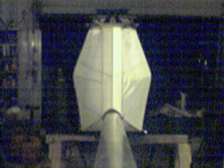

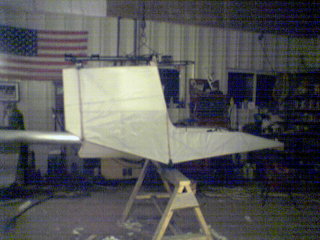

ElleryWeld(at)aol.com Guest
Posted: Fri Jan 19, 2007 5:22 am Post subject: Reducing drag |
Visualize this then, but I am not the only one that has done something like this to reduce drag
Ellery

Posted: Fri Jan 19, 2007 7:03 am Post subject: Reducing drag |
something like
| this to reduce drag
| Ellery
Hi Ellery:
Built the mkIII in 1991 with fabric V tail on fuselage. Lasted less
than 100 hours before prop pulses beat it to pieces. Showed the
problem to Ray Stitts at Sun and Fun 1993. He said the only solution
would be to put fiberglass insulation in the V to soak up pulses and
prevent drumming of the fabric. Other option was replace with sheet
metal, which I did. Used .020 alum. Works great.
We had a V tail on the Firestar, but the 40 hourse 447 did not cause
any damage.
_________________ John Hauck
Titus, Alabama |

Joined: 09 Jan 2006 Posts: 4639 Location: Titus, Alabama (hauck's holler)
Posted: Fri Jan 19, 2007 7:20 am Post subject: Reducing drag |
The Polytone along the diagonal fuselage side brace on the passenger
side of the MKIII had cracked as far as 18" ahead of the prop on mine
Richard Pike
Richard:
I foresaw the rear longerons and prop pulse problem when I covered my
mkIII. I used reinforcing tape and fabric stitching to keep the
fabric from drumming in that area. That fabric has nearly 2,600 hours
on it.
Titus, Alabama |

jbhart(at)onlyinternet.ne Guest
Posted: Fri Jan 19, 2007 7:37 am Post subject: Reducing drag |
One way to support the fabric is to use a foam form as shown in:
http://www.thirdshift.com/jack/firefly/firefly93.html
So far, this fairing has withstood 122 hours of propeller thumping.
Jack B. Hart FF004
Winchester, IN
Posted: Fri Jan 19, 2007 10:46 am Post subject: Reducing drag |
Richard
I have some where around 300 hours on this and no problems with it so far but I did use Heavy fabric on that area
Ellery

APilot(at)webtv.net Guest
Posted: Fri Jan 19, 2007 2:00 pm Post subject: Reducing drag |
Thanks for the pictures. That is a neat solution and looks good. I left
my fuselage open in that area on my Mark III Classic. My thinking was
to get the cockpit air to the prop. I am probably only getting drag.
Vic in Sacramento
